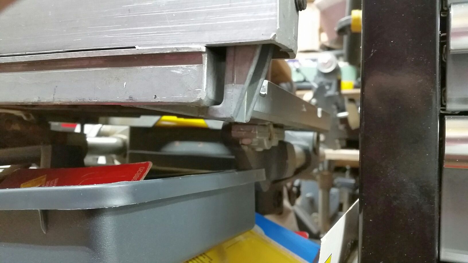

Re: Shopsmith 500 rip fence question
Mine looks like this and works fine, original from 1976:
JPG wrote:
JoeManes wrote: . . . It just jams against the bottom side. . . .
Thanks
Joe
Not an 'issue'. It is supposed to work that way. The back edge of the table is beveled. The 'hook' has a rounded shape on the end. That slides on the bevel and pulls the fence down tight to the table. The result is the fence is jammed between the 'hook' and the table top.
See what happens when you depend upon memory rather than current 'looking'! :o
See Ed's pix above!!!
