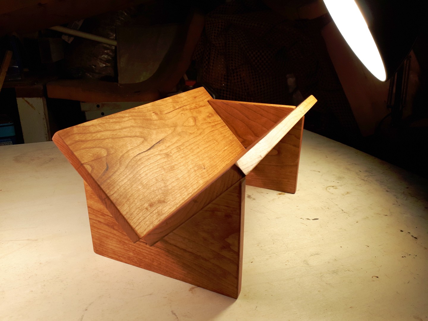

My daughter has many hobbies and often has me make her tools/equipment for presents.
This year she has started doing bookbinding, and for Christmas she asked me to make her a punching cradle. The signatures of pages are laid in the trough and an awl is used to punch holes along the fold, (there is a small gap at the bottom of the "V", this makes it easier to sew them together.
punching cradle.jpg (245.04 KiB) Viewed 8977 times
I don't know what kind of wood it is, (maybe cherry?), but it was a joy to work with an I really like how it turned out. :)

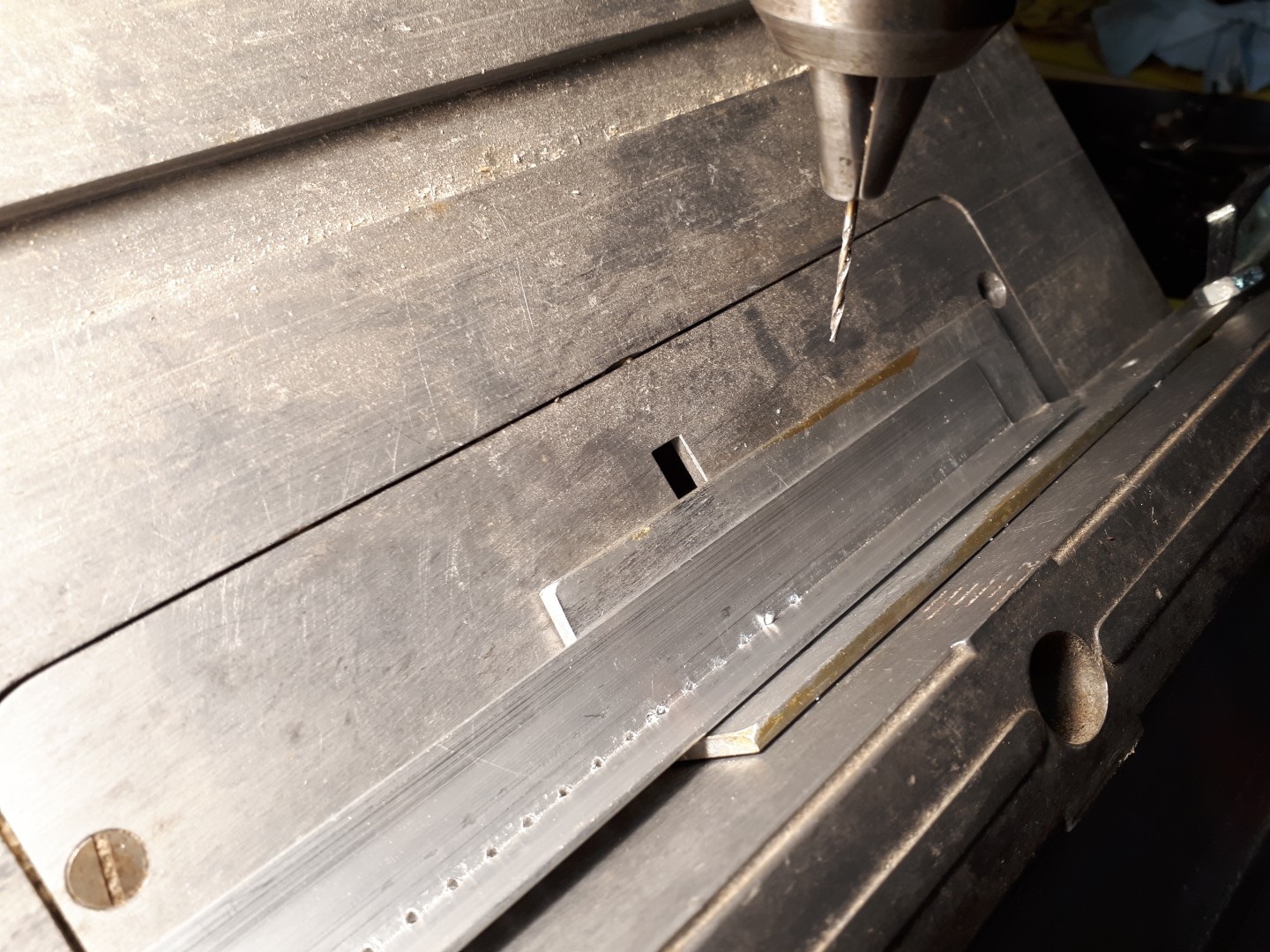

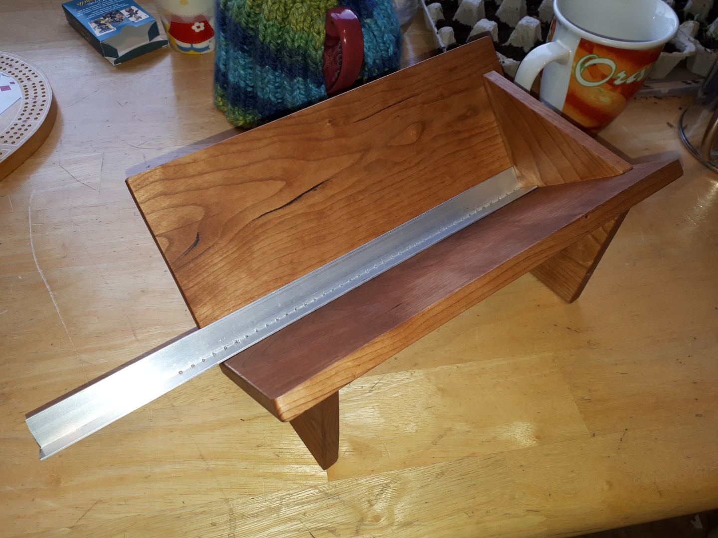

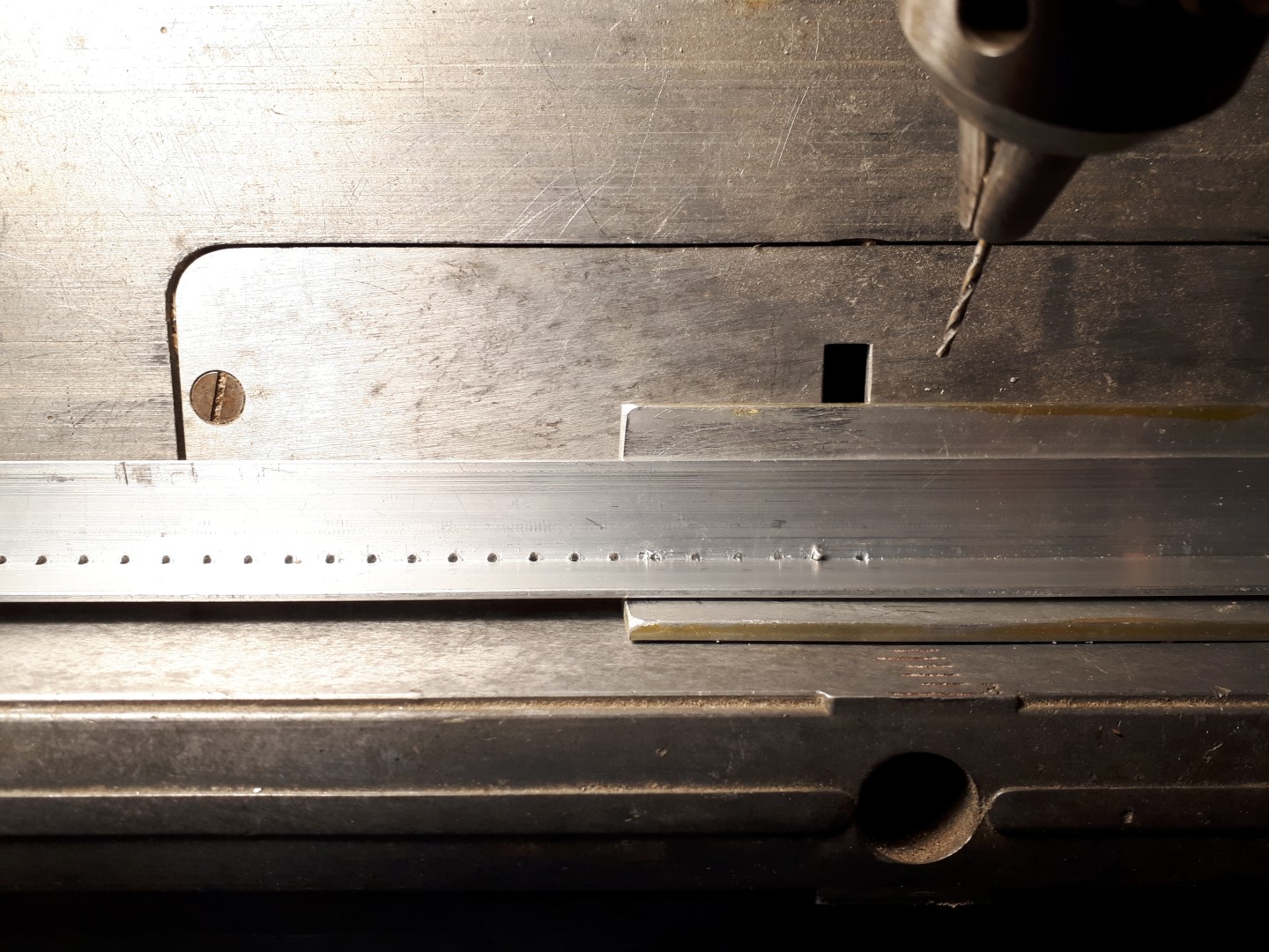

About a month ago I made a guide to go with the punching cradle, to make it easy to space the holes evenly.
To drill the holes I set the table at 45° so the fence acts as a v block, and I made a spacing jig with some aluminum angle and a broken drill bit for a pin. I still had to center punch the hole locations or the bit would wander.

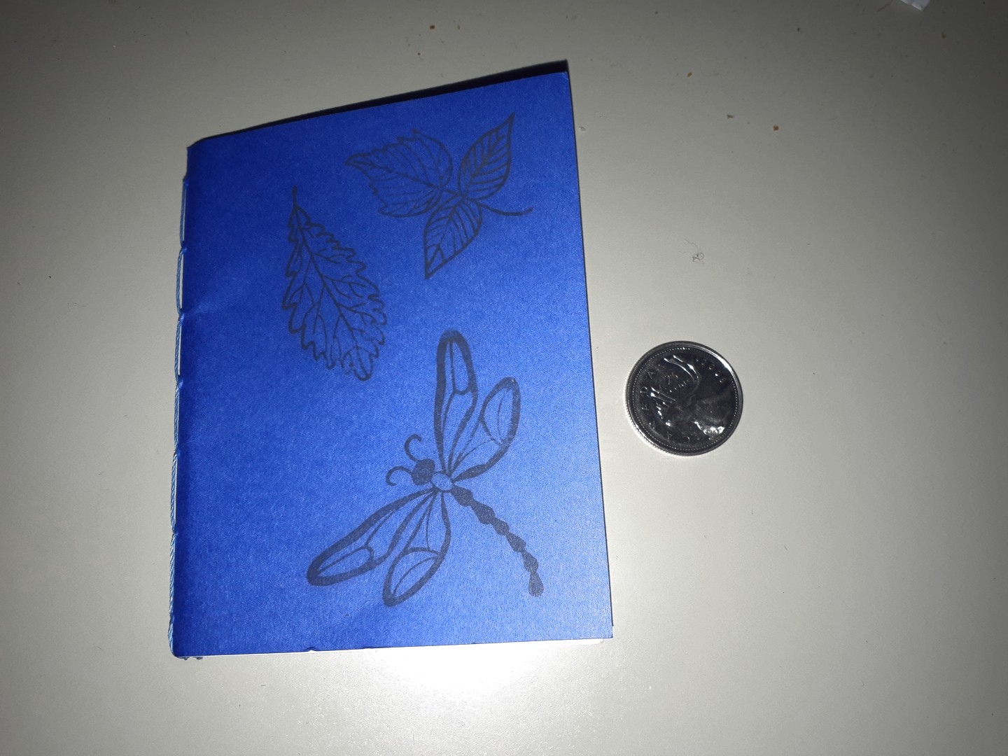

Today when I went to visit, my daughter gave me a small notebook that she had made with the aid of the punching cradle. :) (the coin is a quarter, for scale)
