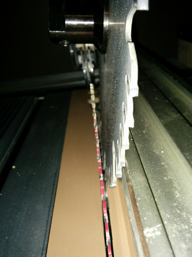

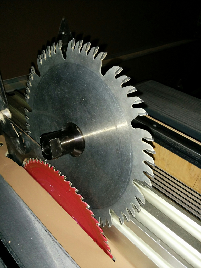

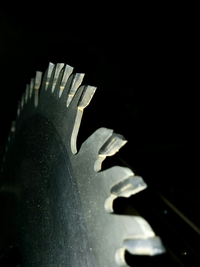

Both blades are 10'.
Here're pictures. (kerf comparison may not show that well, but Freud is thinner).
Are carbide tips dull? (it appears pretty sharp to me... :-)
