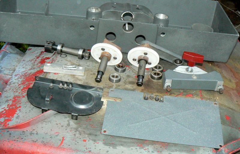

It's clean as can be, plastic gears are virgin. Ran smoothly without excessive vibration. Basically mint condition so I bought it.
The serial number appears to be NOV 16 and some smudged out character(s) after that. The manual is marked "PL-5156 Rev 4/88. Any idea about the date of manufacture?
I'm going to order a set of extra plastic gears for it (#98 on the diagram, SS PN 515089) and the upgraded blade change kit. And some premium casters for my Mark V just 'cause ;)
Is the pinion gear metal? (#96 on the diagram, SS PN 515329)
Any other parts I should get while I can?

Re: Older Gray Scroll Saw, is it servicable still?
I would not be concerned with the nylon gears.
IIRC the drive pinion is steel.
Yep looks like steel to me!

They're only $3.03 each, cheap insurance.
When I went to rebuild mine the only wear item that needed replacing were the bushings, something that shopsmith no longer sells. However JPG had already worked around this with some close bushings that are easy to modify and get to work. If the upper arm can be pushed side to side then those are the bearing areas responsible.
I did the upgrade for the blade system as well, well worth it to me.
As far as gears, no noticeable wear on them, if you want to replace them fine but I don't think they will ever be an issue for as long as we live.
