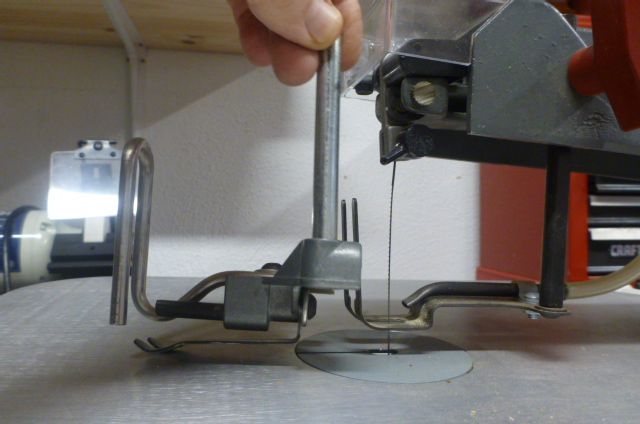

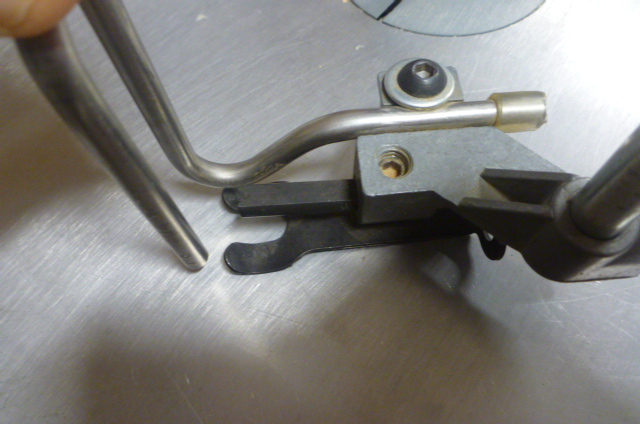

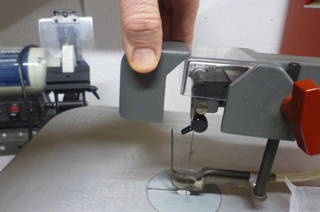

I went back and looked more closely and I think the full upgrade kit really isn't necessary. The new blade blocks are all you really need (555708). The new hold down design isn't better, it's just lower cost to manufacturer. I would remove the rear blade support and use the existing hold down. Then either cut the "Scroll Saw Arm Hood" down so that it doesn't interfere with the new blade blocks or order the new clear hood (518163). The "Scroll Saw Tension Lever" is very convenient compared to the knob and I might add that to my order (518127).
Some pictures:
Some pictures:
- The Scroll Saw Arm Hood comparison. The old one needs to be cut back to aviod interfering with the blade block.
- P1050835.JPG (139.5 KiB) Viewed 9163 times
- Comparison of old and new hold downs. New hold down is simpler but not better.
- P1050836.JPG (137.5 KiB) Viewed 9163 times
- The rear blade support can be removed in the old hold down by removing the grub screw.
- P1050837.JPG (140 KiB) Viewed 9163 times

Fantastic! That picture you show with both hoods side by side is exactly what I needed to see. I tried using the saw without the rear blade support, but being a rookie I think I need the ‘training wheels’ attached for nowP89DC wrote:I went back and looked more closely and I think the full upgrade kit really isn't necessary. The new blade blocks are all you really need (555708). The new hold down design isn't better, it's just lower cost to manufacturer. I would remove the rear blade support and use the existing hold down. Then either cut the "Scroll Saw Arm Hood" down so that it doesn't interfere with the new blade blocks or order the new clear hood (518163). The "Scroll Saw Tension Lever" is very convenient compared to the knob and I might add that to my order (518127).
Some pictures:
I have a used set of the upgraded holders on the way to me now, I now see that I will need to remove/cut the old hood to fit. Easy.
These original blade holders are a PITA as JPG said, they work but are cumbersome, especially for fret work. The installation fixture is part of my table and I do use it for the lower holder to get the blade sitting properly.
When I contacted my local SS rep All-in-One last week they said the 555706 kit is not available, and 555708 is on back order.
Thanks again for posting those pics.
