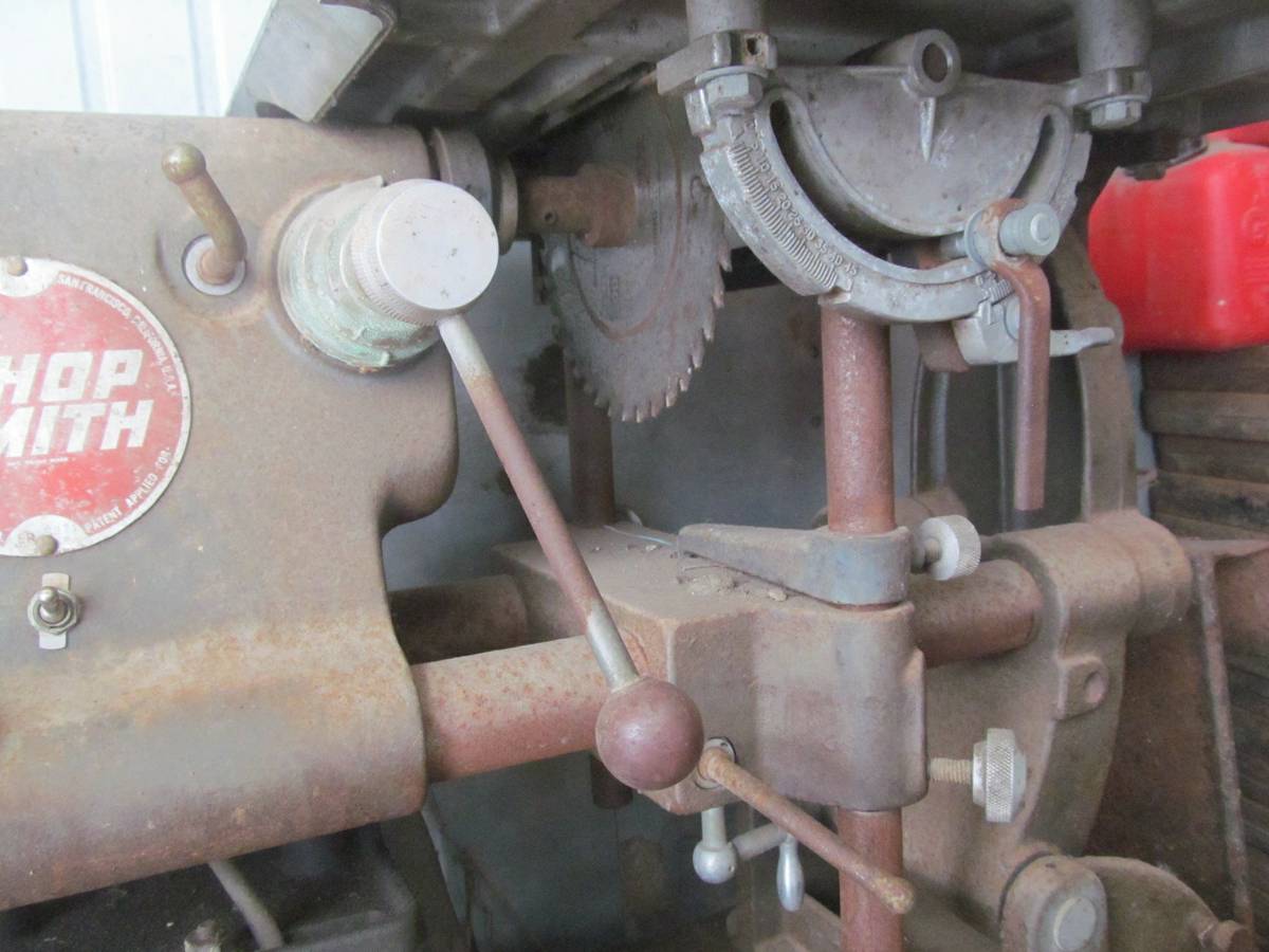

Here it is as found. These are the CL listing pics, except for the trailer one:

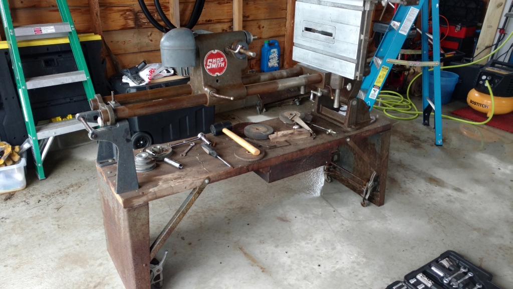

And here is how it sits in my garage now, with some mild initial cleanup. I've moved everything on the way tubes as little as possible until I get some Evapo-rust I ordered at my wife's work (a True Value hardware store). But I have been disassembling things a bit at a time mainly for inspection, but also to correct any small issues I find.
As you might pick out from these pics, I had to bend one of the leg supports straight and put new longer lag bolts in all the way around to stabilize the thing. It was wobbly and rocking around and the wheels on one end wouldn't lift high enough to roll it. I was considering just making a new bench or turning it into a dedicated drill press with a small square base. I found out it was because the leg on one end was bent in from the brackets being bent and disconnected, so now it is fairly rigid and I think I will end up keeping the bench, or at least the legs and making a new slab to similar dimensions.

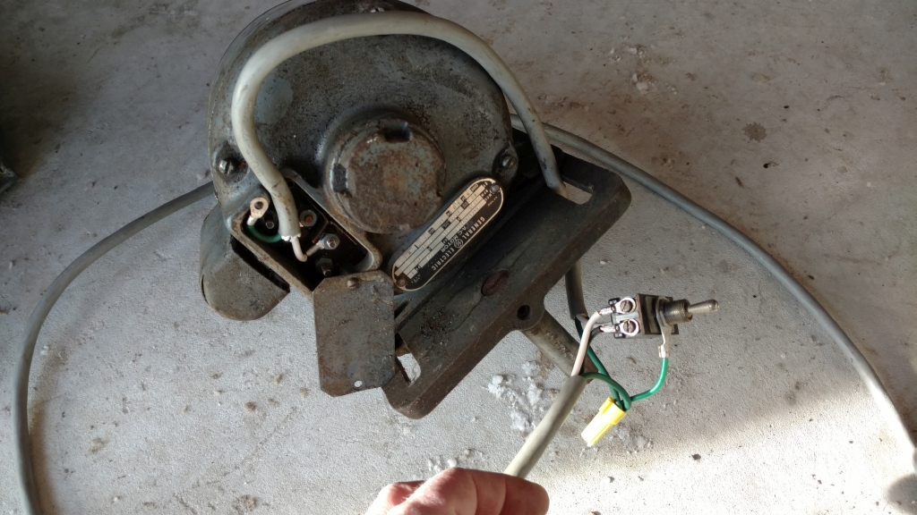

One of the first things I found out was that the power cord was shorted before the switch. The insulation was all cracked off and the wires were twisted together. After unscrewing the dust cap on the motor, I found the short wire was in the same condition. I ended up using some scavenged parts to make a new cord and ground the machine but still make it serviceable for future changes. Then I started thinking about using a treadmill motor, so now that's in the back of my mind too. I used to work at a bike/fitness shop and at times they have decent treadmills heading for the dumpster, with 2-3HP larger motors in them. I'll keep hanging around that shop until something shows up.

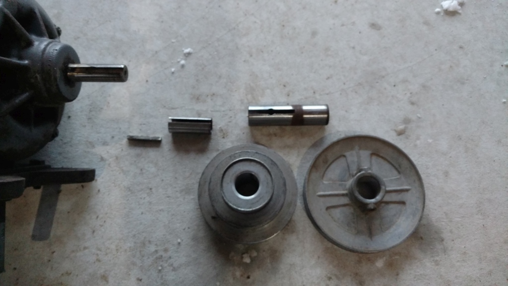

After I got the thing running and could listen to the motor and bearings (everything spun fine by hand with no play, but I know enough to know that doesn't mean it will be quiet), I moved on a little at a time, trying to figure out what I had. I looked up the jointer attachment and found from other posts here that the headrest I have is supposedly rare. So now I am being a lot more careful around it. I might not have tied a strap around that part while on the trailer had I known. Then after finding out what drove the jointer, I deduced that the pulley setup I have may not be what came from the factory, but could be part of the jointer kit, with the triple pulley being replaced. Others may know more about how this would have originally come, but you can see from this pic that there are two step down bushings to get down to the motor shaft size.

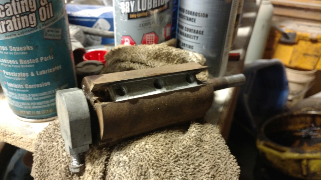

I took the jointer cutter head out for inspection, as it was full of cobwebs and I couldn't really clean anything out while in the unit. The jointer and its table is by far in the worst shape of any of the parts.

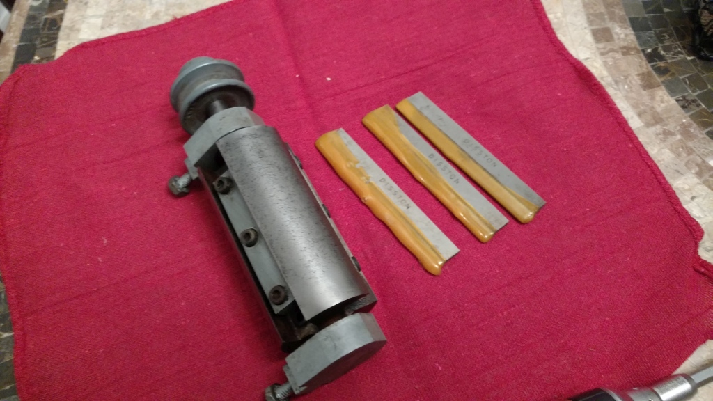

Here's after wire wheel treatment, and having a neighbor with a grinding business sharpen the blades.
It will probably be a bit before I get the jointer back together, as I'm making a list of all the bearings I'll need to pick up. I tried repacking these but I can feel a small hitch in the outer one, so that made up my mind to just go all new everywhere and not bother repacking any more. One good thing, there is a really good bearing supplier near me that I just contacted today, and they said they stock or can get any Fafnir bearing I want, so I should be able to save on shipping. BTW, my neighbor only charged me $8 for sharpening. As there were nicks in each blade in the same spot, I didn't want to bother sharpening them myself the first time.
