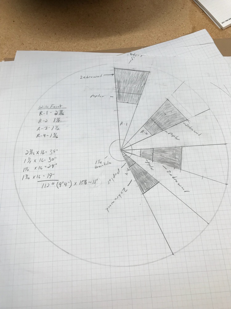

Turning a pedestal
The next project involves a zebrawood and ebony pedestal to hold a decorative sink bowl. I am going to turn the pedestal in three sections and then join them. The top bowl will be a segmented piece and the main column will be laminated up 8/4 zebrawood in either linear fashion or also segmented. The base will be a ring of ebony.

Hmmmmm. Moma sketches the shape and thee figgers out how to make it?
I assume the 'blocks' drawn on the top piece sketch will be triangles?
"R" = radius at different 'depths'?

Yes. Doing the full scale drawing is the only way I can make it work for me.

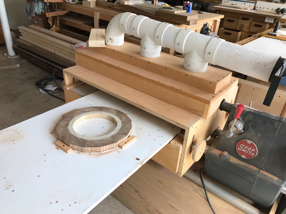

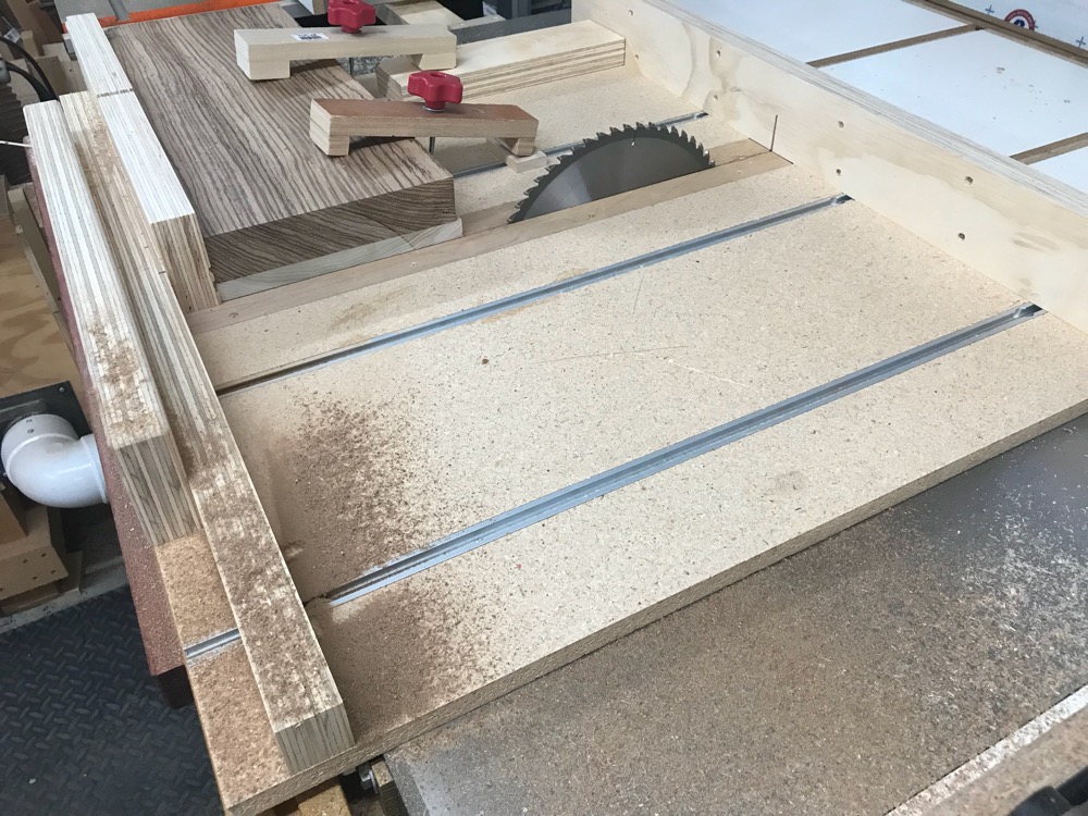

Re: Turning a pedestal
So I hit a slight snag in slicing the zebra wood which is laminated to a piece of poplar. When I got the new table saw it required me throwing out all my old sleds. I spent the last day building a new sled and managed to get it done just in time to leave town for Albuquerque. Now I can get down to making rings this weekend.

good looking sled

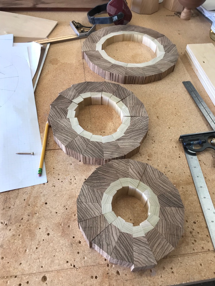

Finally got some shop time and moving forward. I sliced up the Zebrawood and the rings are now finished. I will sand them flat tomorrow.

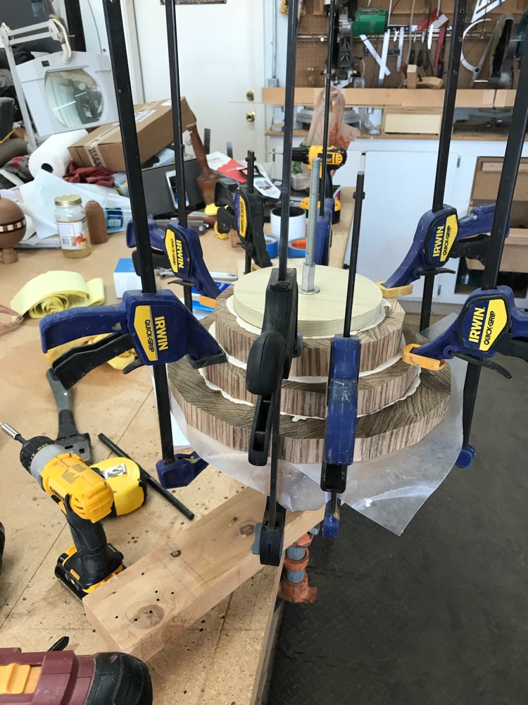

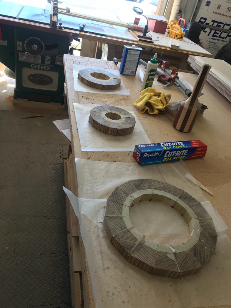

Managed to get out in the shop for a few hours and got the discs sanded and then glued up. Hopefully get to turning it tomorrow.
Paul
