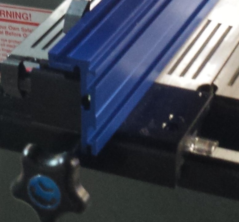

I really LOVE my Kreg Bandsaw Fence! I went on the Shopsmith Page and found a reference to it, but only some supports and NO photographs. I've seen the fence in action and I was in a woodworking shop (where I eventually bought it) and there was a Shopsmith [Bandsaw] Owner in there that the Kreg Fence couldn't be installed in the SS Bandsaw.
The Kreg Fence comes with 2 sets of mounting screws, 1/4-28" and 6mm. The 6mm is a tad smaller than 1/4" and the front of the SS Bandsaw isn't very wide or thick, so I used the 6mm, drilling and tapping the 2 mounting holes.
Setup was a breeze, taking only a few minutes. After making a near-perfect resaw, I took the fence off and them put it back on and made another resaw cut that was the same as the original. I did this because, as all SS Owners know, the blade comes out the front to change.
The picture really doesn't do it justice, 'cause I had to crop the heck out of it to get it on the Forum.
Well worth it!
Well worth it!
