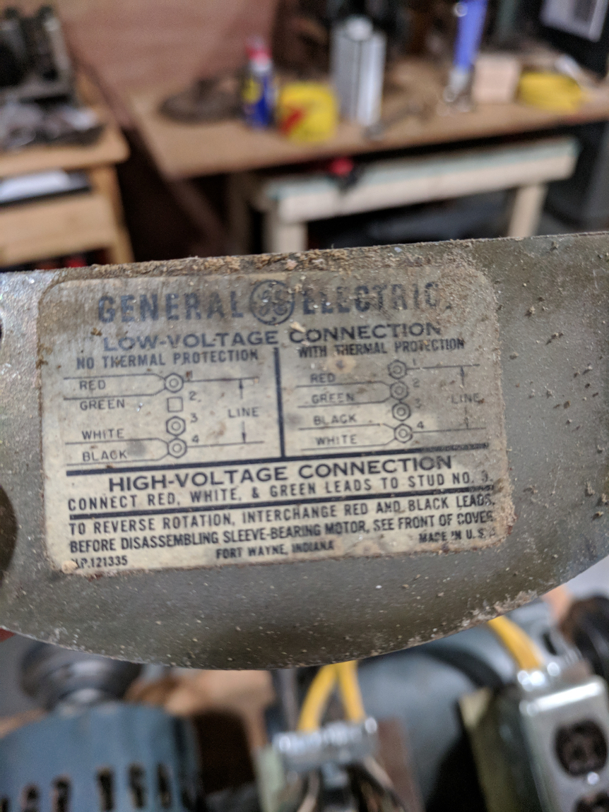

- Wiring instructions inside 3/4hp motor
- IMG_20180206_222825.jpg (974.09 KiB) Viewed 8412 times

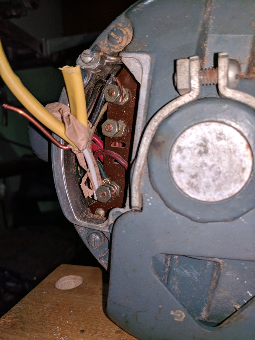

- 3/4hp motor studs
- IMG_20180206_222801.jpg (943.29 KiB) Viewed 8412 times

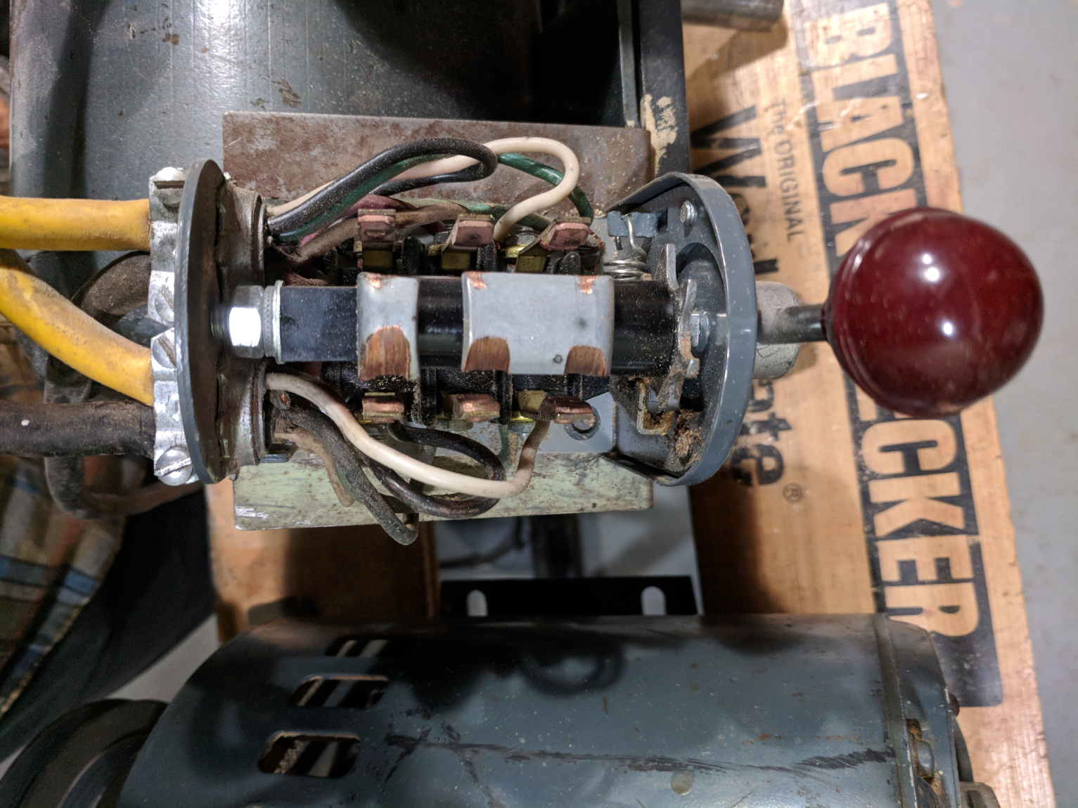

- Forward/Off/Reverse Switch
- IMG_20180206_222729.jpg (1.64 MiB) Viewed 8412 times

All 4 internal motor wires need to be connected to the switch. The switch must connect power across the white and black wires in both forward and reverse.
The switch must also connect the red and black wires to the white and black wires, but are reversed between forward and reverse.
I am unfamiliar with the switch pictured, but it has to have the on/off/on switching action for controling the power. Separately in must provide the flip of the red and black wires.
The pix on the switch only reveals 6 terminals, but the wire count coming from the 4 power cords is more than twice that. Are there other terminals that are not visible? Is there an addition copper part similar to the one in the pix, but on the reverse side?

I really like that cool old drum switch you have, and would like to find a similar switch for my own vintage machines .. the knob looks identical to ones on my 50’s vintage DeWalt radial arm saws. Does your switch have a manufacturer and model number on it somewhere?
Whilst Googling for similar switches, I happened across a video explaining how to wire up a modern reversing drum switch. It might help you better understand JPG’s instructions.
[youtube]https://m.youtube.com/watch?v=ilpKrdvQkQA[/youtube]
Re: Motor Wiring
The switch is a Dayton brand. I didn't see a model number on it, the label was covered by some tape to mark forward and reverse.

JPG, thanks for the info. I'll see if I can get some better pictures of the switch after work tonight.JPG wrote:All 4 internal motor wires need to be connected to the switch. The switch must connect power across the white and black wires in both forward and reverse.
I think I'm starting to follow what you said. I might have to draw up what I understand and see if that aligns with what you're saying.

It would be helpful to verify switch operation if pix were posted showing the switch in both forward and reverse positions.
Re: Motor Wiring
That makes sense, I can grab some photos of the forward and reverse positions this evening.

Noticed the ground wire is cut so it is questionable if the ground is carried to the location those wires are going.... First circle to the left.
It looks like an excessive amount of wear on the contacts, is that normal for these switches? We used rotatory switches in the telephone projects but never the voltage or currents involved with this sort of motor.
