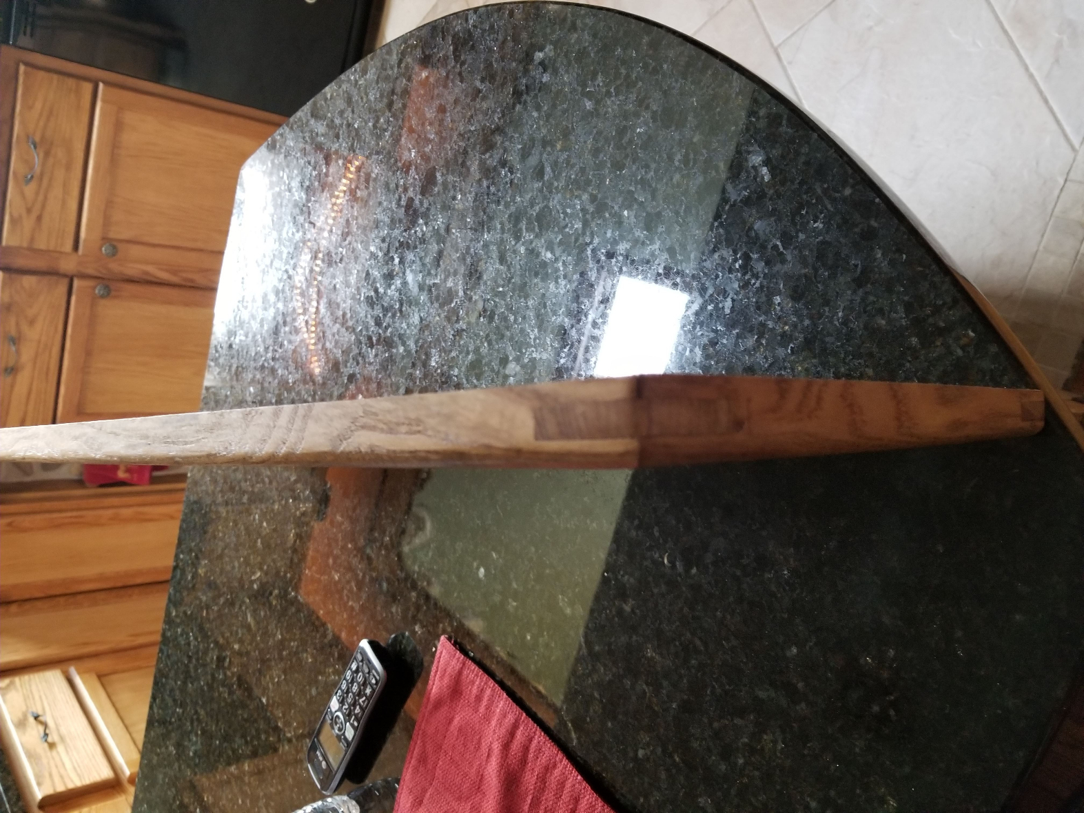

If I can do it again I got it made lol
I have a couple more to post this was the first attempt that worked .
So I had to make a end for the cabinets used the tenon jig on the corners , I am starting to think this floating tenon may be my favorite way to make 45 deg corners .

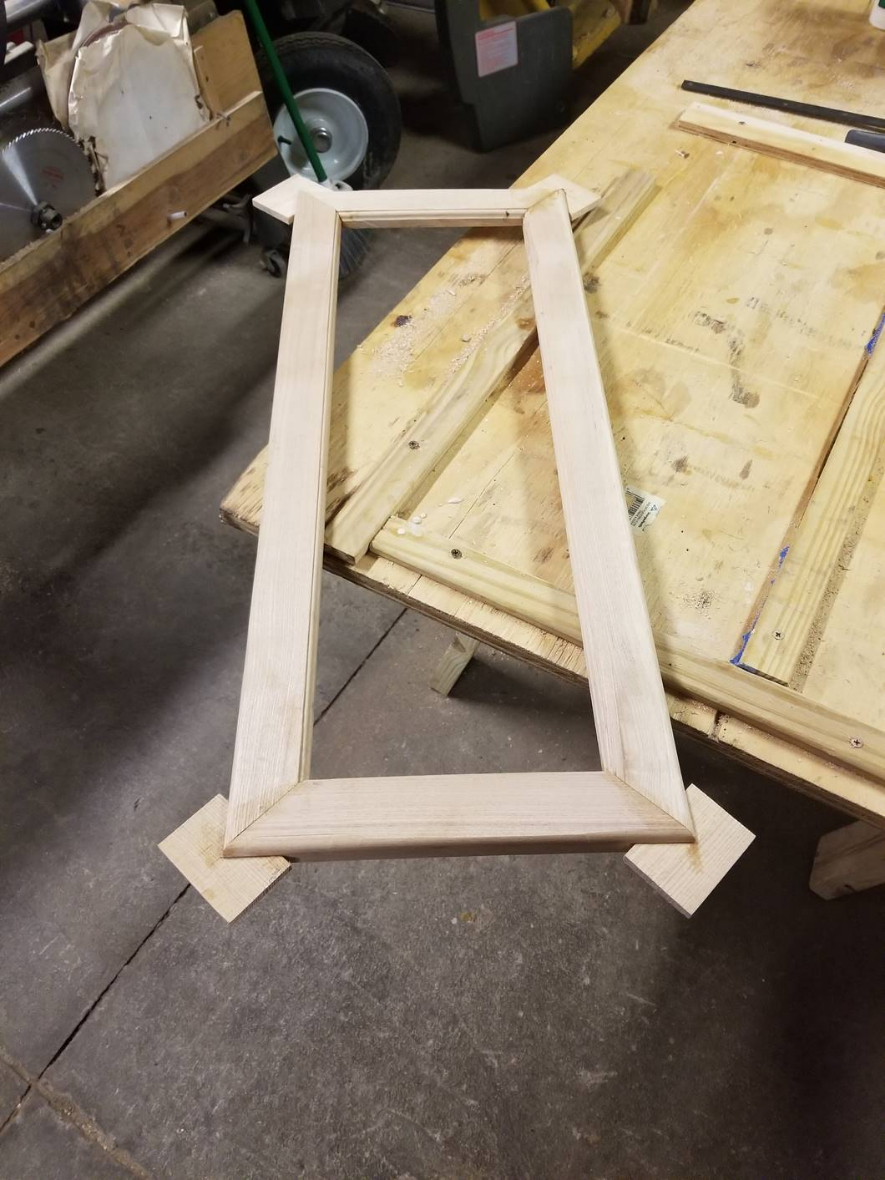

I made a jig on the plywood to keep them square and identical ,,I made 4 total 2 were only 1/2 the length .
For some reason the program wont allow me to shrink thee height ,

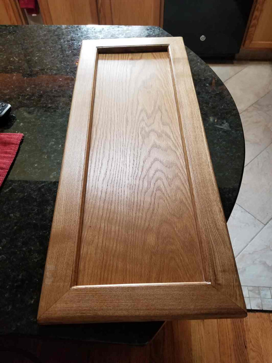

these are ash stained a golden oak when setting beside a piece of oak I cant tell the difference

It looks just like oak to me. Is Ash cheaper to buy than oak? I've never seen it available around here so I haven't looked into using it.

I think it depends on where you are located as to price. Ash grows predominantly on the East coast. I have gotten it cheaper than oak from a local saw mill/lumberyard. I paid $17 for 1" x 11.5" x 11.75' of Ash while about the same size piece of Oak was about $28 last year. From what I understand this saw mill only buys trees/logs from the local area so what is available and price varies.

Ash is about to become extinct here because of the ash bore , one of the local mills I hear now is selling it for over 1.50 bdft green ,,, good trees are getting tougher to find. the trees are rotting on the ground .
