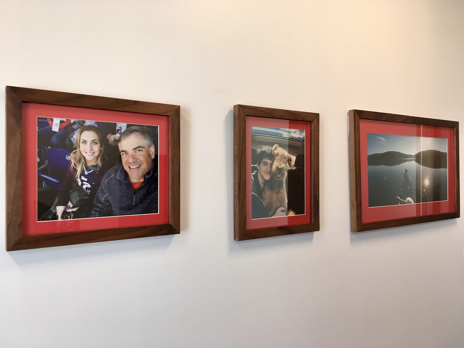

3 Simple Picture Frames
algale
Posts: 4828
Post by algale »
These are nothing special. Just walnut finished with tung oil. But the miters were done with hot hide glue. Mostly posting this to bury the spam that was on top of this forum.

It does have an odor but it is not overpowering or offensive to me. I wanted to begin using hot hide glue because the clock project really demands it, in my opinion.
I have been amazed how easy hot hide glue it is to use. It was great for the picture frame project because it sets up so quickly that I was able to apply the glue to one joint, put the joint in my Stanley picture framing clamp, and within a matter of minutes the joint was sufficiently cured that it was strong enough to be self supporting and take out of the clamp, which allowed me to the next joint. In less than half an hour, these frames were not only glued but totally out of any clamp and getting a first coat of tung oil applied. With regular glue, I'd glue one joint at a time, wait 24 hours and move to the next. Even if I were to use one of those clamps that does all 4 joints at once, it would be 24 hours after glue up before I'd remove it. This really made these frames fast and easy.
I also have to give a big thumbs up to a pure tung oil finish. I'd previously used a finish that claimed to be tung oil (MinWax) but it was full of other things and contained minute amounts of tung oil. A pure tung oil finish is super easy to apply, builds faster and looks nicer. Wouldn't use this on something that needed a high gloss finish, but it was great for these frames. Gives a look similar to BLO but without some of the problems associated with BLO (no yellowing with tung oil).

Those are very nice, did you put a rabbet around the perimeter for the glass and photo?
algale
Posts: 4828
Re: 3 Simple Picture Frames
Post by algale »
newportcycle wrote:Al,
Yes indeed. If I recall correctly, 1/4 inch wide by 1/2 inch deep. Stock is 3/4 deep x 1 inch wide. That's about as basic as a frame gets.
