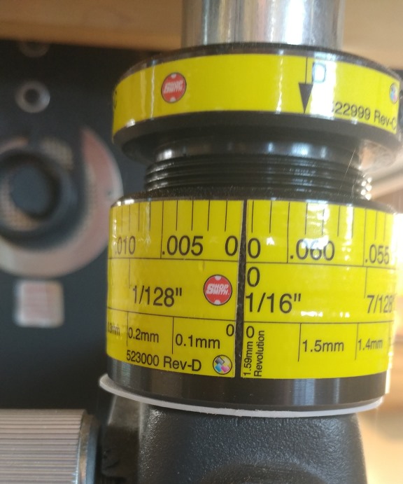

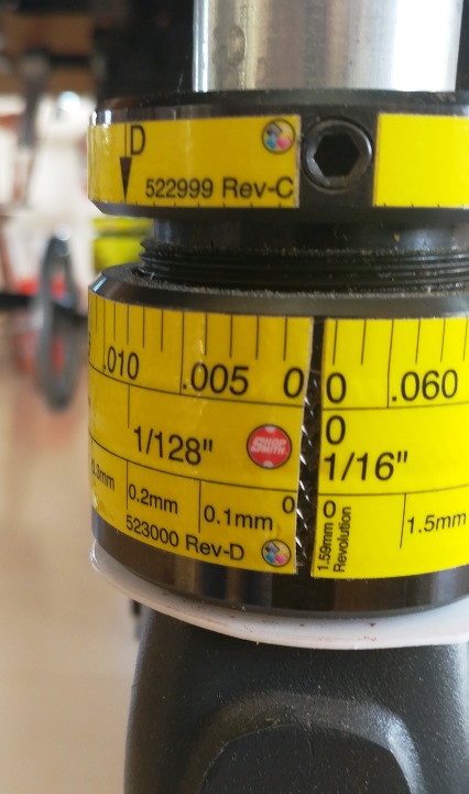

You are spot on Mike. I have 4 here. The stops were ordered when SS first offered them years ago. The scales came out some time later and I ordered them when they first came out. All of mine have a gap even though the manual say they don't/shouldn't. As I remember I had to trim them per the instructions. It is not hard to over trim ever so slightly. If you look at the pictures it is obvious that the ends of mine are not straight. The pictures show two of the gaps. The other two actually meet at the top but have a gap below the top scale.Mike907 wrote:I actually have two of the adjustable stop collars with the scales. One has a gap of 1/16", and the other has a gap of 1/32". For the purposes of the adjustable stop collar, however, it wouldn't make a difference if the gap was an inch or more. The marks are just relative positions. For instance, suppose you wanted to adjust the collar 27/128". 27/128 = 3/16 + 3/128, so pick an arrow A, B, C, or D and line it up with any of the 1/128" marks, tighten the set screw, then rotate the collar three full turns (3/16") plus 3 of the 1/128" marks. For any adjustment greater than 1/16", you're going to have to do the math to figure out the proper number of rotations and fractions of rotations.
Your adjustment procedure is correct so the gap does not matter.
- 20180316_141910_Burst01.jpg (99.44 KiB) Viewed 21688 times
- 20180316_142024_Burst01.jpg (83.78 KiB) Viewed 21688 times

Looking at JSB's two collars it SHOULD be obvious that there is NO QUALITY issue! Look at the spacing between the "0" and the .062" index marks. They are very close to .0005" or one half thousandth which is what it should be!!! The gap is intentional! The resultant spacing is barely one ten thousandth(less than two ten thousandths) deviant from perfect.
The surface upon which the scale is attached is knurled. Not a precision surface by any means, so IMO it is amazing that it is as accurate as it is.
I doubt the screw threads are much more accurate as the minuscule scale 'error'.
Keep in mind the collar was not initially designed with a scale in mind, but the scale was developed much later.
All this consternation is much ado about nothing.
As I have twice pointed out, the gap is not only inconsequential, but intentional and necessary and has no bearing upon the accuracy.
If we are going to judge things and criticize designs and/or manufacturing precision, we must first understand that which we be squawking about.
