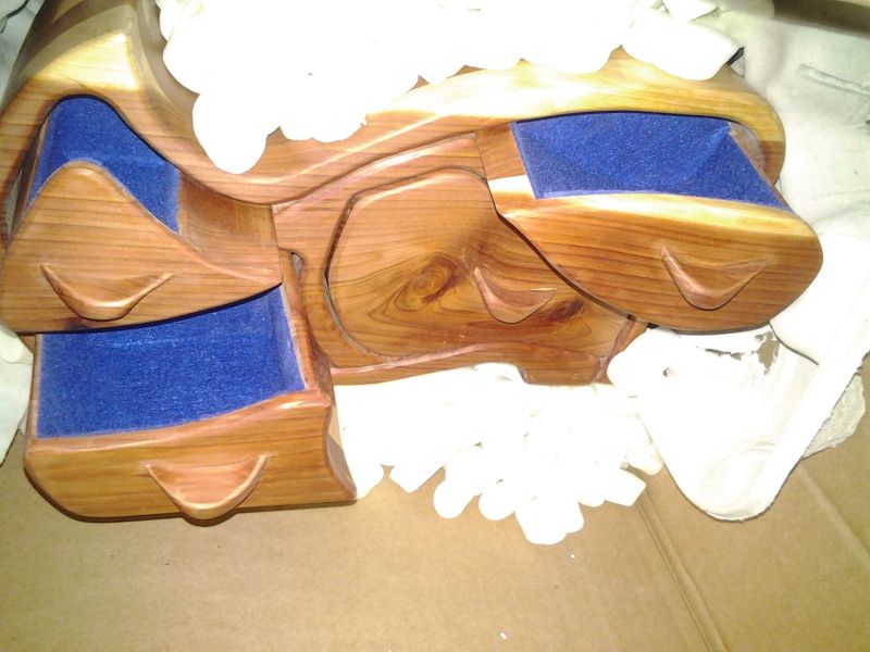

I often make bandsaw boxes of laminated boards. The final measurement is 6 X 6 X 12. I cut off the back with 1/2", then cut out the drawers with 1/8". Yes, they break when there is too much to cut. I have broken welds and in between. The saw blade simply spills out. It is always my fault as I push it while making curves.
