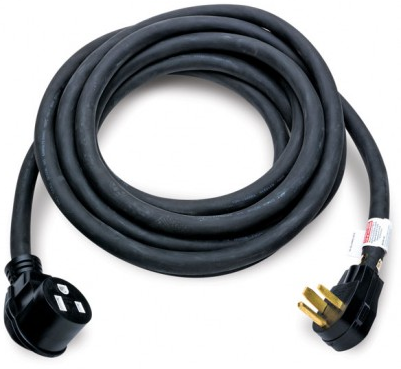

I have a 25' 220V extension cable that I got from Eastwood for my welder. I am sure there are many other ones made in different configurations.
Something like that if the connectors are right might make a big difference for you in the PowerPro.
I always hesitate on custom building electrical due to insurance.
If we had a fire and the fire Marshall said they found non standard wiring present in the rubble, the insurance adjuster would try to wiggle out of covering it, even if it could not be attributed to the cause.
Just something to consider even if you can make the pigtail yourself.
