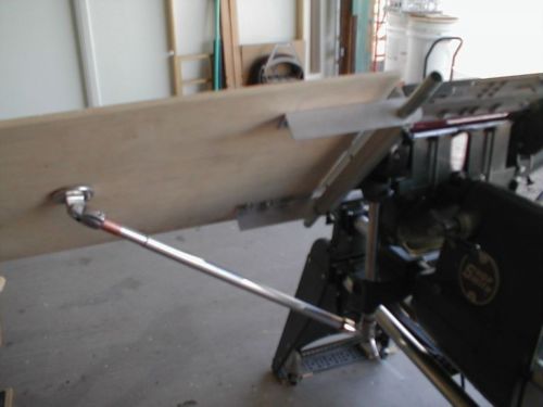

I saw this on eBay awhile back and thought it was an interesting idea. The person was selling some of the parts used to make it. It is for the 510 and 520 table systems and only required adding a short tube in the bottom of the back table post as the only modification to the Shopsmith.

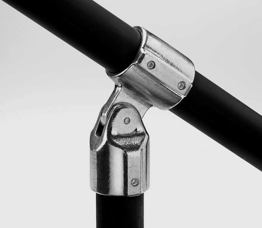

It uses this type of hardware to provide the ability to swivel.
Since it is only attached to the table system it is set once made. Height and table angle changes follow changing the table itself.
My only concern is the weight supported solely on the back of table system.

- outfeed table 3.jpg (20.61 KiB) Viewed 11571 times

What is interesting to me is that looks very much like my outfeed table. Maybe I should have marketed mine.chapmanruss wrote:I saw this on eBay awhile back and thought it was an interesting idea. The person was selling some of the parts used to make it. It is for the 510 and 520 table systems and only required adding a short tube in the bottom of the back table post as the only modification to the Shopsmith.
As for your concern about weight I would say nothing to worry about. I use mine on a very regular basis.

I like it, yours seem a little simpler and the parts would be easier to find. More common parts like the PVC and less specialty parts.
Right now I use the floating tables (I have 4) and the Shopsmith brackets along with the tubes & legs to make my out feed table.
