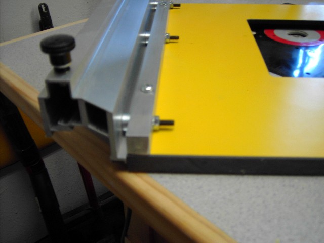

You are correct on the model # and I couldn't find anywhere to order just the 22" x 17" table either. I guess you could call cust. svc. at 800-619-1298. I'm sure you should be able to order one since it is an option to the system. As far as the cost, I would think it would be less than the cost of a 24" x 32"- $140. The Insert Plate (RP60) is on sale for $50.Do you know if you can order just the table and insert plate? Any idea of cost?
I think the table model number is model #STT-2217P but I couldn't find it listed outside of the package.
The table comes with an aluminum bar on the bottom that the fence rails mount to.How do the SS fence rails mount to the table? Directly or indirectly to something like angle iron/aluminum?
(see attachments)
I don't see why not since the table has the 520 fence rails... the same as an extension table. Although ( I'm sure you know) you will need to add an aux. face to it.Can the 520 fence be used with it?
- Front Rail.JPG (45.4 KiB) Viewed 11504 times
- Rear Rail.JPG (70.45 KiB) Viewed 11463 times
George
Ft. Worth, TX.
Go TCU Froggies
Ft. Worth, TX.
Go TCU Froggies
George;
Is that an aluminum bar or aluminum square tube that the rails mount to?
The aluminum bar is attached to the underside of the table with what looks like screws. Are these screwed into inserts inb the table? Is yes, do the inserts go in from the top (can you see them in the top).
PS You can do part number searches in Jointech's online catalog for those items for can't find.
