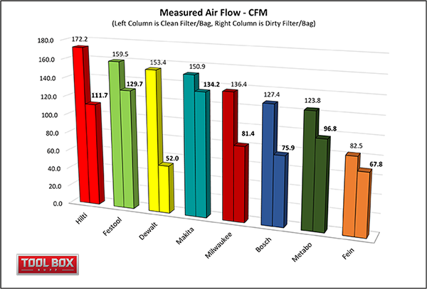

I came across this article that I found very useful comparing similar vacuums to the CT26. What I found interesting is how the CT26 had a relatively small reduction in airflow for a "dirty" bag condition. Most vacuums suffer when the bag gets full and/or the filter gets clogged (why I only run my ShopVac with the cyclone in front of it). The only vacuums that beat it were the Fein and the Makita. I heard mention in a video that the Festool design has a suction that keeps the bag contents sucked to the bottom, so the bag doesn't fill up prematurely and choke off the intake - to prolong bag changes. If this chart is to be believed then perhaps a cyclone isn't a must have accessory to the CT26 given this design feature. Of course, I would prefer to empty a cyclone dust bin and maximize airflow (versus time), but just pointing out that perhaps a cyclone isn't necessarily needed on the CT26 given this. The HEPA filter would still be suspect in my opinion, so a cyclone probably has a lot of value for the CT26 over long term use.
https://www.toolboxbuzz.com/head-to-hea ... d-to-head/
