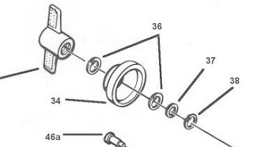

By the way, what is the right way for the 2 tongue washers to be installed? Mine are installed so that the serrated sides face each other.

Eugenius wrote:Thanks. I'll try that later and let you know.. (My SS is back in saw mode and I'm busy elsewhere today.)
QUILL SERRATED WASHERS.jpg (9.55 KiB) Viewed 24503 times
Washers (36) serrated sides face the 'dial' (34).
