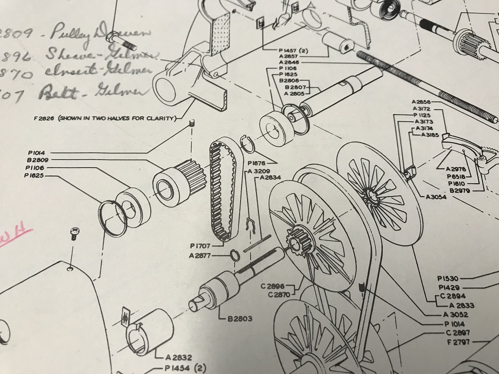

I am requesting scanned copies of anything related to product announcements, production changes, dealer notifications, service bulletins, and product end of sale notices.
First Year Production Greenies – Wide Casting Sprue on Headstock – Sand Cast Headstock Mark 5 designation.
The first ones had a solid drive sleeve and a toothed Gilmer type Belt (but no clutch) and the single bearing quill. – Sand Cast Headstock Parts Illustration and first generation manual is something I do not have to work with.
The second Greenie series had the Gilmer Belt and added the Clutch so it would slip (opposed to bending things) when something like a blade jamming stopped the rotation of the spindle.
The third series of Greenies were not Sand Cast but Injection Molded with a thinner sprue (where the hot liquid metal gets injected, opposed to poured). They also had an access hole and SS Cover on the back side to access the lubrication point on the Quadrant and the oil hole (early ones had no oil hole) in the Control Sheave.
First Year Production Goldies introduced the Poly-V belt circa 1960 and by
1962 the 3/4 HP motors in them was upgraded to 1 1/8 HP, which was an upgrade option available for existing 3/4 HP machines.

NONE of the Mark 5 (all colors etc.) had a two bearing quill.
Two bearing quills were introduced by SS Inc. after the 510 creation(???).

Here are some dates, events, and questions
Source: Nick Engler
• 1953-early 1954 Headstocks were Sand Cast and had wider casting sprue
• 1954 Headstocks were injection molded and had thinner casting sprue and
• 1954 Rear inspection hole added
• 1953-1960 Two Tone Green Paint (Greenies)
• 1960 -1963 Two Tone Brown Paint (Goldies)
• 1962 Headstocks made before 1962 (Serial No. 37143) have 3/4 horsepower motors
• 1962 Beginning with (Serial No. 37143) headstocks had 1 1/8 HP motors
• 1962 Headstocks made before 1962 (Serial No. 37143) used Gilmer Belt Drive changed to Poly-V
• 1963-1967 Machines were painted a smooth gray
• 1973 Prior to (Serial No. 1001), the way tubes and bench tubes had thicker wall DOM tubing
o Prior to 1973 Way tubes were plated; Bench tubes were painted.
o Starting 1973 all four were plated and had thinner wall DOM tubing
• 1973-1984 Machines were painted a smooth gray
• 1984 Machines were painted a rough gray
• 1984 After (Serial No.190000) Machines have a two-bearing quill.
• 1985 Prior to (Serial No. 196119) Mark 5/V model was only model produced 510 with larger table and new fence afterwards. They referred to the prior model as the 500.
• 1988 Shopsmith began using the date of manufacture as the serial number in form: mm/dd/yyyy
• 1991 Shopsmith introduced 'C' headstock (Serial No. 01011991) with a red safety switch
• 1999 Shopsmith beginning with (Serial No. 01011999), introduced the Model 520 with a larger and more stable “Pro-Fence” system.
• 2010 The Mark 7 Power Pro was introduced which kept the upgraded Pro Fence and Table system.

What was the date and serial number the Gilmer Clutched Drive Sleeve Assembly was introduced?

Everett,
You made me look. I have an original Mark 5 Manual Copyright 1954 (Cat. No. EM-1900-MS-3:54) that shows the Drive Sleeve Assembly parts (shown below). Part B2809 is named pulley - driven and is held on the drive sleeve (B2807) by a set screw (P1014). I have another original Mark 5 Manual Copyright 1954 (Cat. No. EM-1900-MS-4/55) that shows the Drive Sleeve Assembly only as a complete assembly part number 202100. A third Manual Copyright 1955 (Cat. No. EM-9100-10:55) that again shows the complete Assembly. The first two are Magna Engineering Corporation and the third is Magna Power Tool Corporation. Sorry I do not have digital copies of any of the above or below listed manuals.
I also have -
an original Magna PTC Manual Copyright 1957 (Cat. No. EM-9100-B 4:57)
an original Yuba Manual Copyright 1957 (Cat. No. EM-9100-C 3/59)
an original Shopsmith Inc. Manual Copyright 1957 (Bulletin No. 504286 1/73)
an original Shopsmith Inc. Manual no Copyright date (Bulletin No. 504286 6/76)
The rest of my original printed manuals are more current ones for the 500/510 the 520 and the Mark 7 plus supplements
Of note the 6 Manuals above with copyrighted dates of 1957 or earlier all use the same black & white pictures of a Mark 5 "Greenie" with 8 screws to hold the belt cover on.

Russ,
I would like to find a way we might scan your original Mark 5 Manual Copyright 1954 (Cat. No. EM-1900-MS-3:54). Especially the illustrated parts drawing and lists in standard 300 DPI and drawings also in high 1200 DPI resolutions.
I thought I had one of the 4/74 Supplement to the Mark V Parts List but I was mistaken.
If you don’t have a flatbed scanner, PM me your full name and address and I will see if I can procure one and have it drop shipped to you.
I will set up a folder on Google Drive (if you have a Google account you can login to) I can then authorize that account to upload files there.
You have some early history documentation I would love to preserve for history.

- Posts: 4534
Re: Calling for Submissions - Everett
I have scanned it at 300 in JPG and the three diagram pages also in 600 in JPG. My scanner only does 200, 300 & 600 DPI in PDF or JPG format. I will send it to the email above.

Thank you Russ!
All files were received and I will begin the process of Photo enhancement and document restoration which will take me several weeks. I hope to finish it by end of summer.
I will publish the result on My Google Drive for the world to see. It certainly helps with the Sand Cast early Mark 5.
I will also use the large format drawings to build out a large format exploded parts drawing with revised axis perspective similar to others I had done for later model.
