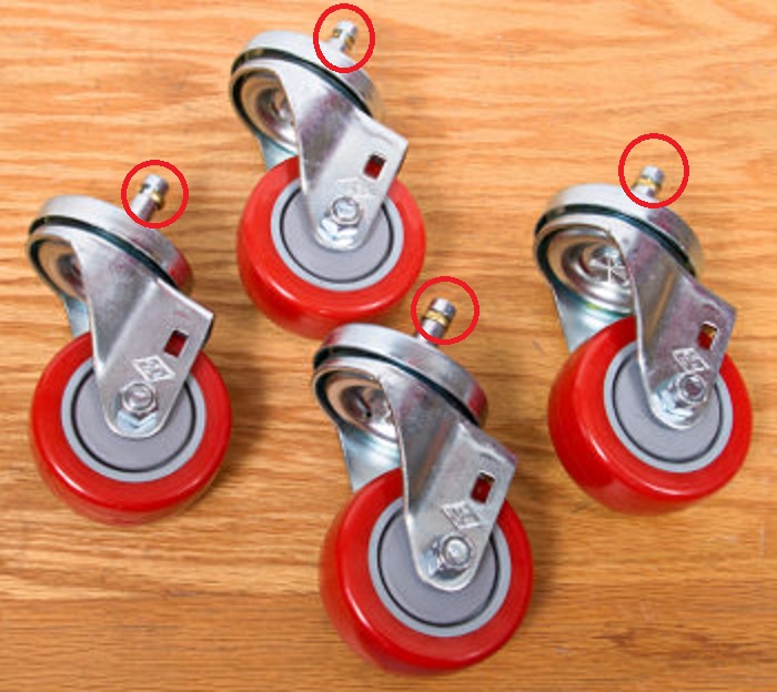

You could try to make the ring near the end of the casters post larger by prying it apart a little. It is that ring that holds it in place. Shown below in red circles.

Thanks Everett and Russ. I did take a look at the brass compression ring. I spread the gap apart but it didn't seem to help much. ??

I installed the same casters recently. Had to really smash that brass collar to get the washer on. The brass collar does not recover on its own, you need to bend it back out quite a bit to get it to where it was originally.

Thanks, RC, I'll take it back out and open it back up a bunch and see if that helps.

When inserting the stem into the bore, you must insure the brass ring does not slip out of the groove and thus require greater force to get it inserted.
