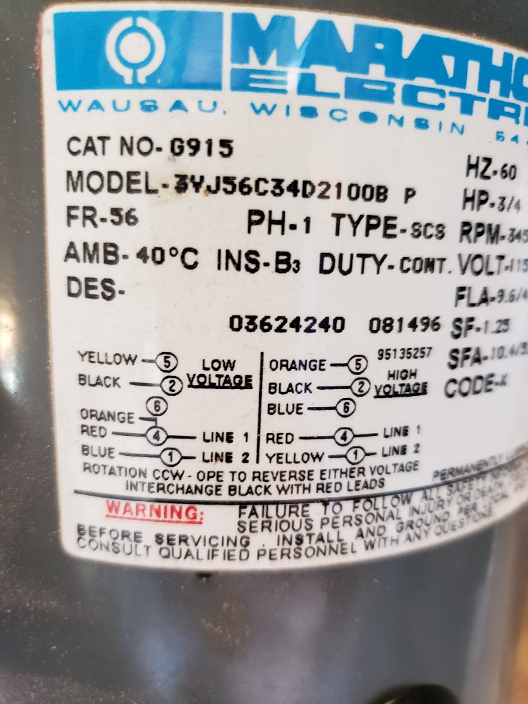

Got my stand for bandsaw set, but one overlooked issue... the motor direction is counter clockwise. Anyone familiar with motor specs that could tell me how exactly I can or cannot change direction? Took a picture of the spec label.

Beave2012 wrote:Got my stand for bandsaw set, but one overlooked issue... the motor direction is counter clockwise. Anyone familiar with motor specs that could tell me how exactly I can or cannot change direction? Took a picture of the spec label.
This the last bit before my bandsaw gets its own permanent stand.
The label says it is reversible. :)
"Rotation CCW - OPE to reverse ... interchange Black with Red leads."
Take off the access plate where the wires enter the motor. There should be a terminal plate.

I was hopingmy guess was right. You gave me the confidence to "rewire" it. Lol. It works. I did not fry my motor and all is good. Thank you.
