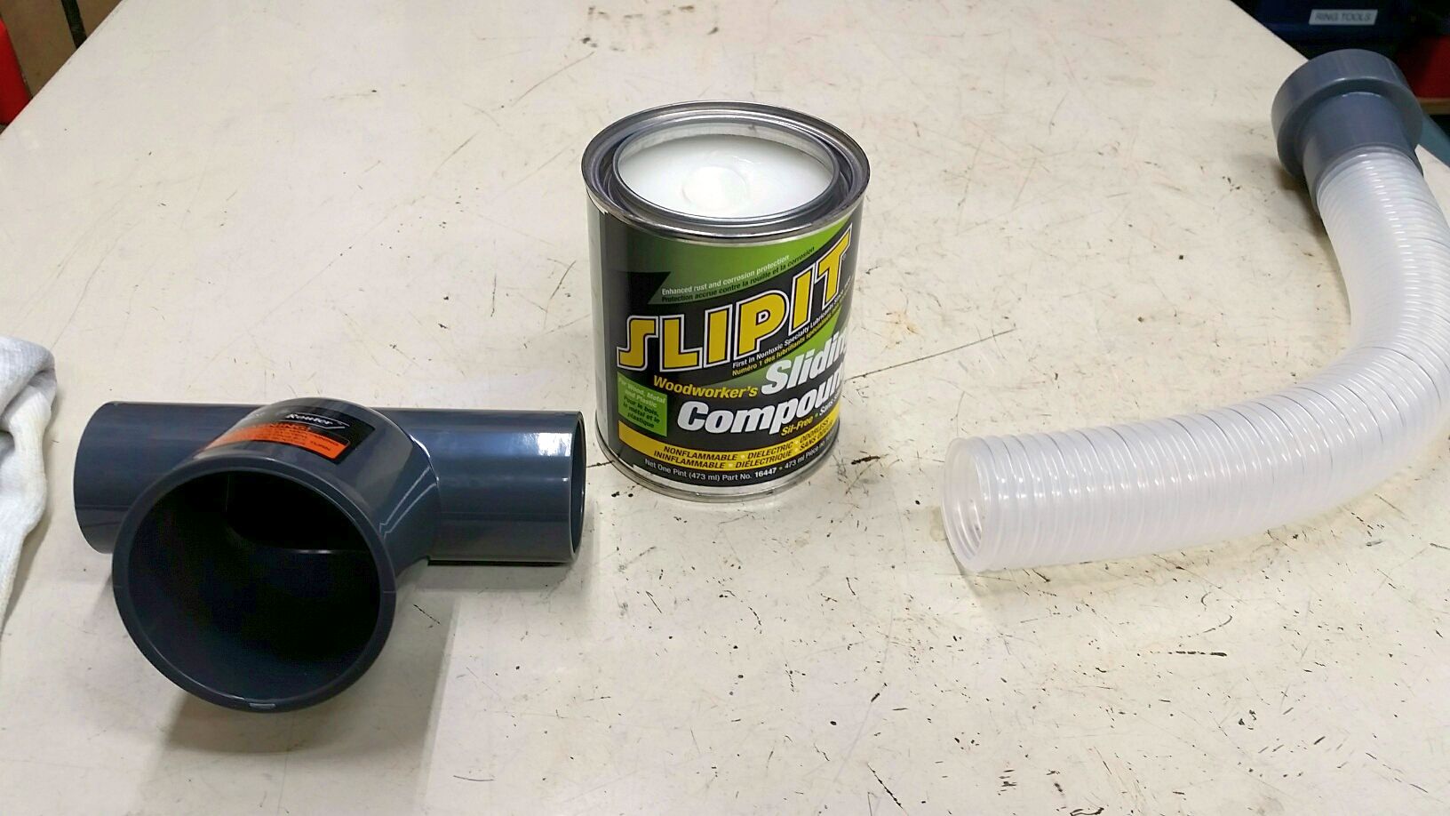

The kit arrived either Friday or Sat. but didn't have time until today to see what it was like. I had my small portable router table in storage so I had to go get it this morning and now have the table setup and ready for some routing.
At first I was a little disappointed, the hose had no intention of screwing into the router.... I had to loosen those attachment screws and then got it in place. It seems to be a nice tight fit and no way will it pull out unless you get really crazy and try to spin the router around your head by the hose.
The first time I attached the short hose to the router and then attempted to mount the router in the table. The hose was just too short so I pulled everything back apart and attached the longer hose. That worked fine.
I then went to assemble the other parts on the hose end. That also left a bad impression as the hose just didn't want to twist in. It would seem the fit was just too tight. Then I thought about putting something on the parts and see if that would help.
I have a can of Slipit that I keep for sticky drawers and the like. It is something I like to have on hand for a lot of sticky situations and this seemed to be a good time to test it out on the connectors and hose. It worked great! Twisted in just like that and changed my opinion on the hose system. I like it now!
I will be doing some routing over the next couple of days so that will of course be the ultimate test, how well does it work for it intended application.
