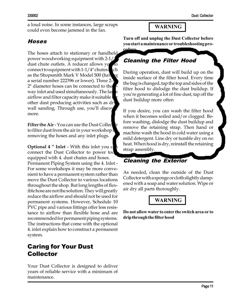

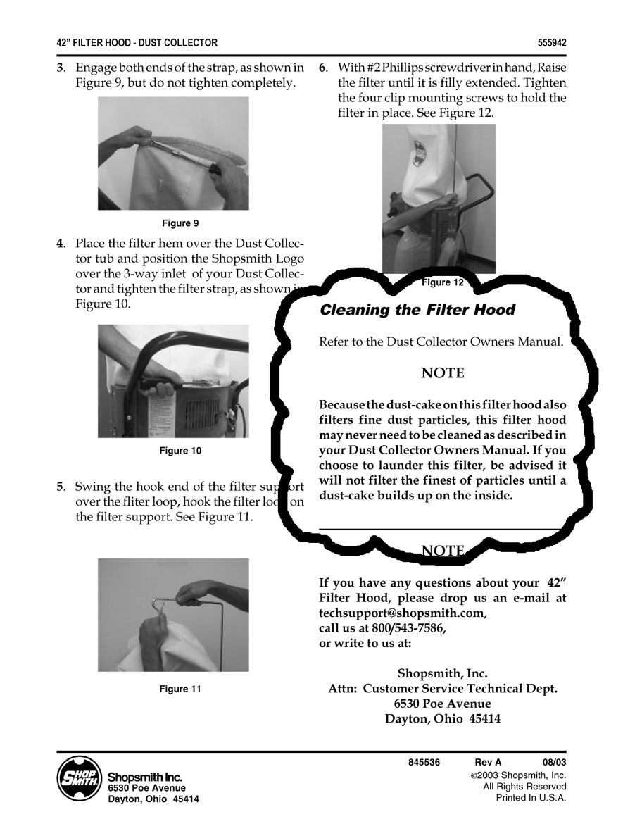

I too have seen the notice about the benefit of some dust cake build-up ... found it in instruction sheet for the 42" hood, but I would think the advice would be true for all 3 hood sizes.
And from the dust collector manual itself, this was the advice on cleaning:
