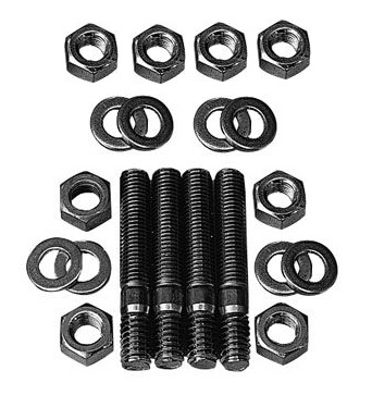

I have a thought for your consideration that involves changing out the studs or converting to studs for tables that did not have them.
My notion was that the course threads on the factory studs does contribute some to the in-ability to adjust the table.
My notion involves swapping out the studs for ones that have the proper thread for the table, but incorporates fine threads on the opposite end providing more granular adjustment since the rotation of the nut produces a finer adjustment.
I know there is discussion on using the same tooth of the blade to insure a proper alignment. I had published the PDF "My Method to the Alignment Process" which involves the larger diameter sanding disc and outlines a good bit of the thought process why I feel it is an easier method.
Equally, the PDF titled "What Can a Single Cross-Cut Tell You?" is a very simple method to find out IF you need alignment in the first place.
They are simple methods, and use use a piece of rod stock, the allen wrench, or a dial indicator to do exactly the same thing with the process.
I had not considered the Nylock Nut component, but that would be an excellent addition the the fine thread stud system I show in the attached photo.
I cannot encourage an owner enough to read those two PDF's as it really helps get one's head around the process.
The early machines had bolts and washers, and newer table designs incorporated the studs allowing for a more granular adjustment.
Everett
Exchange Table Studs to Course Mount and Fine Threads - Everett.jpg (47.48 KiB) Viewed 7198 times

Can the factory installed studs on the extension tables be removed?
