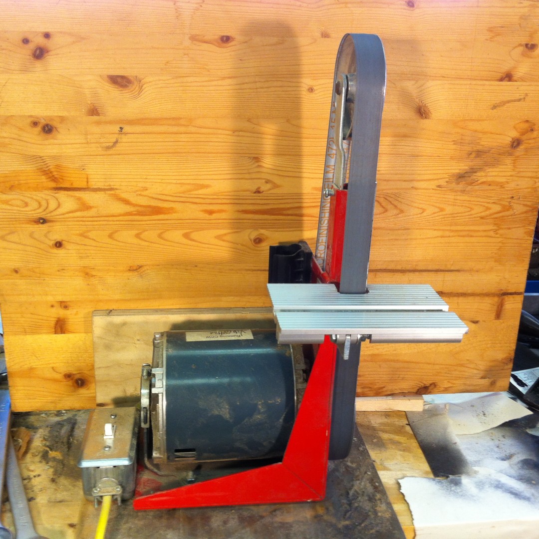

Does the Shopsmith Strip Sander have any advantages or disadvantages?
I have a Delta strip sander now.
Delata Strip Sander
Delata Strip Sander
Delta Strip Sander.jpg (132.04 KiB) Viewed 12089 times
I've searched the forum the only things I found mine can't do is internal sanding and the platens.
What would you use the internal sanding for?
Are the curved platens useful? What do you use them for?
If I have a reversible headstock, can the Shopsmith strip sander be run in reverse?
Re: Shopsmith Strip Sander vs Standalone Sander
rlkeeney wrote:Does the Shopsmith Strip Sander have any advantages or disadvantages?
What would you use the internal sanding for?Large external Concave edges(Bowed legs?)* as well as inside cutouts
Are the curved platens useful? What do you use them for?Small*** concave surfaces
If I have a reversible headstock, can the Shopsmith strip sander be run in reverse?I see no reason it cannot**
Also the narrow belt/platen.
Like all SPT, ya need a SS to power it(changeover etc.).
* the ability to sand using the top pulley as a curved platen.
** The lathe chisel jig requires running in the 'opposite' direction which requires reverse mounting the sander(quill shaft end). A reversible headstock eliminates the need for quill end mounting.
*** As in not smaller than the platen radius which in not all that small.
P.S. NO miter gauge slot in the table.
