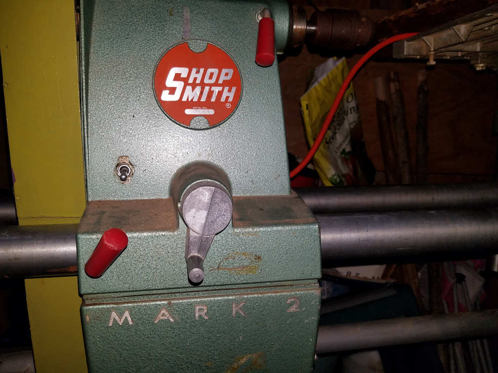

I just bought an old Shopsmith Mark 2. I really had no idea what I was doing, but it was pretty cheap, and I figured for a drill press, table saw, and lathe, it seemed like a good deal.
It turns out, it didn't come with a lot of the parts it needs (like I said, I had no idea what I was doing). I'm trying to figure out what parts I need to get going, and if parts for the Mark V will fit on the Mark 2. It came with the drill chuck, table for the table saw, the tool rest for the lathe, and some lathe chisels.
I really just want to be able to use the table saw and start learning how to turn. I'm thinking I need an arbor for the table saw, a tailstock, faceplate and/or chuck, and a center for the lathe. Should that be enough to get me started, or am I missing something? Any other advice for someone starting out?

Welcome to the forum. If you post a picture of what you have the members will tell you what you will need. Many MarkV parts will indeed work/fit. Bob

Thanks Bob. Here are some pictures of what I've got

The saw function will need an arbor and a blade and a miter gauge(Mark 5/V version will work).
The lathe function will need a spur drive center, a tail center and a Mark 5/V tailstock. The Mark tailstock mount may be in a box of parts(not easily recognized). It mounts on the aux table which I cannot tell if you have. I recommend the Mark 5/V tailstock regardless.
The drill function will require some evsporust to clean up the chuck.
Welcome here!
I do not know if/of a Mark 2 blade guard.

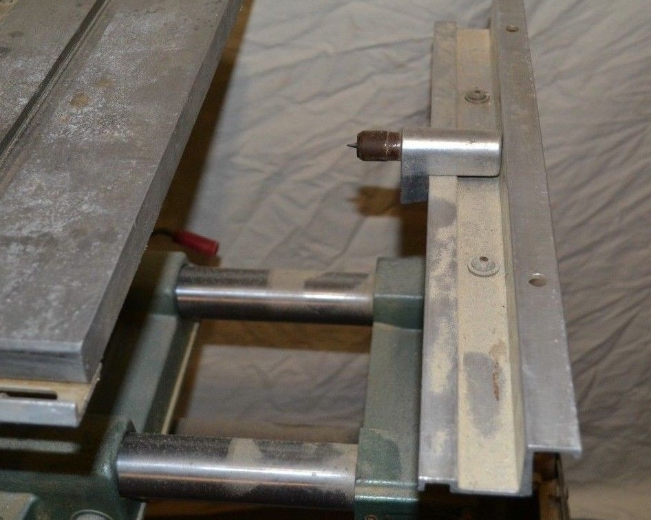

Below is a picture of what the Mark 2 Tailstock looks like attached to the extension table with a lathe cup center. If you do not have it than you can use JPG's suggestion of the Mark 5/V tailstock. If you do get a Mark 5/V tailstock for it make sure you get all the needed parts - Tailstock, the adjustable center and stop collars.
Mark 2 extension table/tailstock

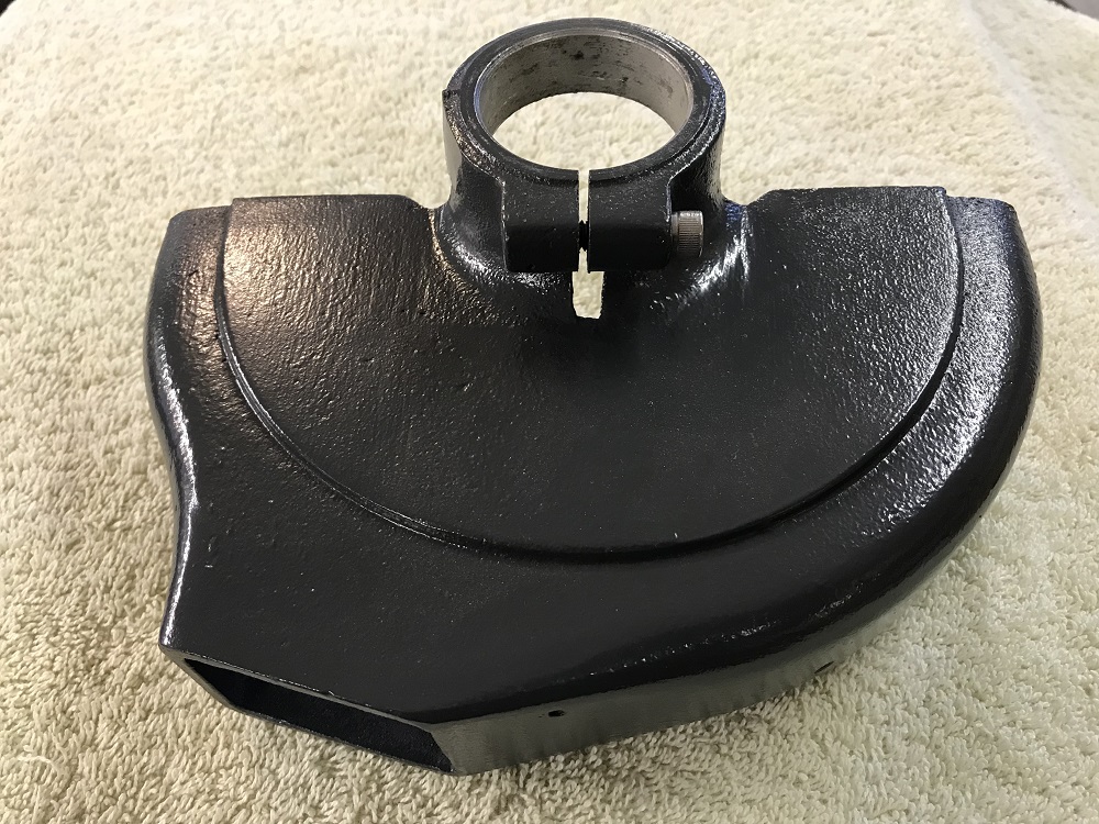

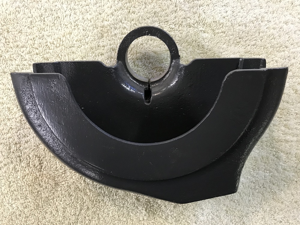

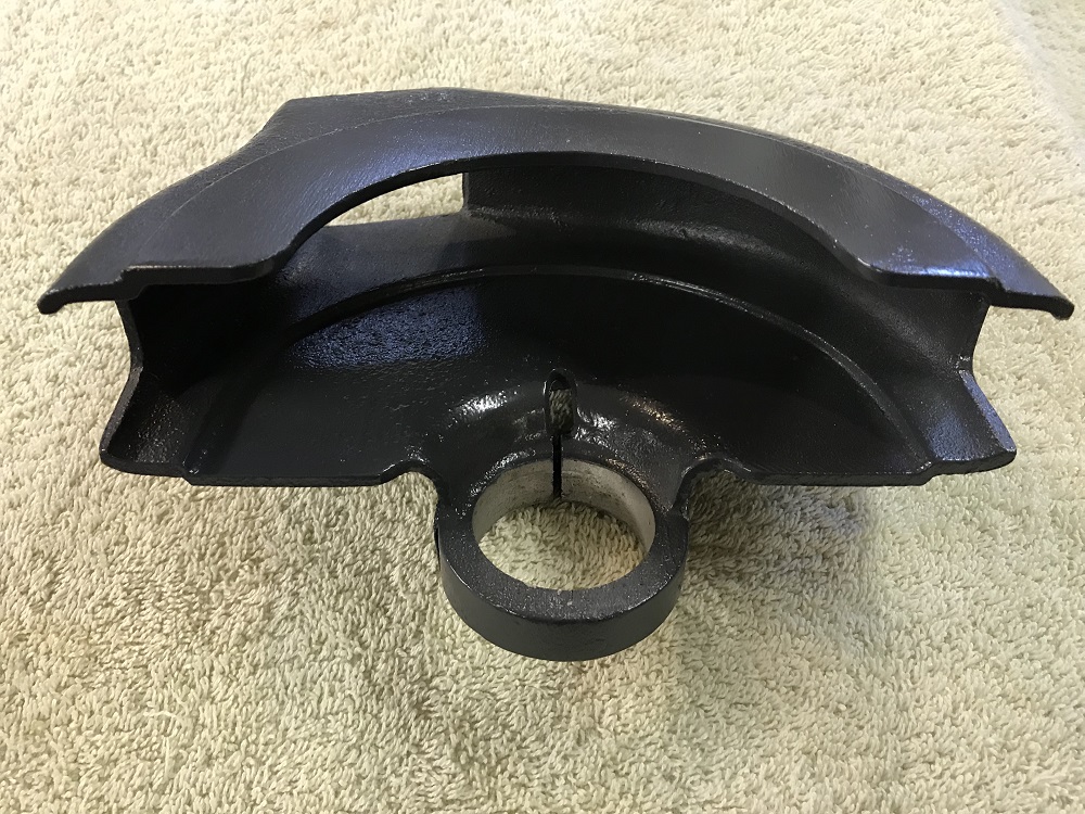

John asked
The one or two pictures of the Model 10 lower guard I have ever seen looked like cast iron as I remember. Is the MK 2 lower guard the same? Also, why do you say it will work with the Model 10 upper guard? The upper guard does no interfere with anything under the table. :confused:
The Model 10 Lower Guard I have is cast Aluminum I believe. Cast Iron would be heavier for the mass in the guard. Interesting the only reference I have for the Model 10 Lower Blade Guard is the November 19, 1951 Part Number conversion table. There are no pictures or part drawings on that table. I have not seen it listed in a catalog until the February 15, 1958 accessory catalog for the Mark 5 and Mark 2. It does not have a picture or drawing of it there either. Below is the Model 10 Lower Blade Guard I have which would be part number 162-1X or 12 370.
162-1X - 12 370 R c.jpg (341.17 KiB) Viewed 58773 times
162-1X - 12 370 L c.jpg (336.69 KiB) Viewed 58773 times
162-1X - 12 370 I c.jpg (349.66 KiB) Viewed 58773 times
I painted it but it was gray when I received it.
As for using the Model 10 Upper Saw Guard it works because there is a threaded hole just like the Model 10's have on the back edge of the table to attach the splitter to. Using the Lower Guard listed in the 1958 catalog, if it is the same Model 10 Lower Guard, requires an independently mounted upper guard. Again there in no picture or drawing of the upper guard in the catalog. The only guard shown is the set for the Mark 5 which is a 9" guard.
If anyone has a catalog or similar source picture of the Model 10 and/or the Mark 2 Lower Saw Guard it would be nice to see.
