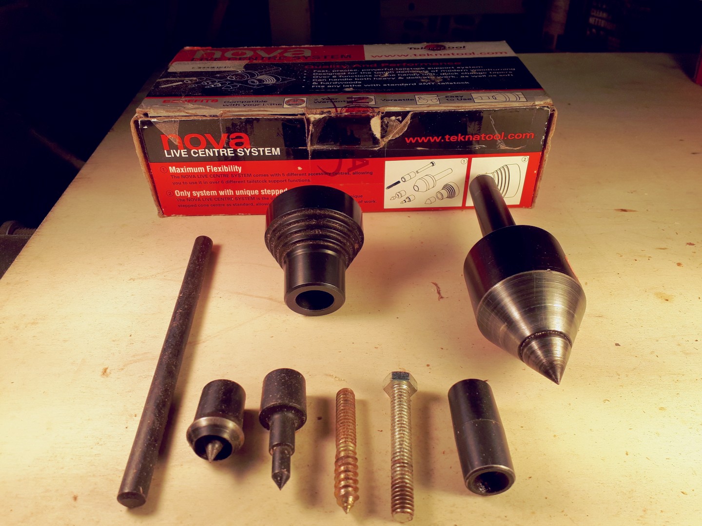

C - Live Center - mounts in the tailstock when turning between centers (has bearings, point turns with work) #2 Morse Taper
this is more elaborate Live Center that has interchangeable points

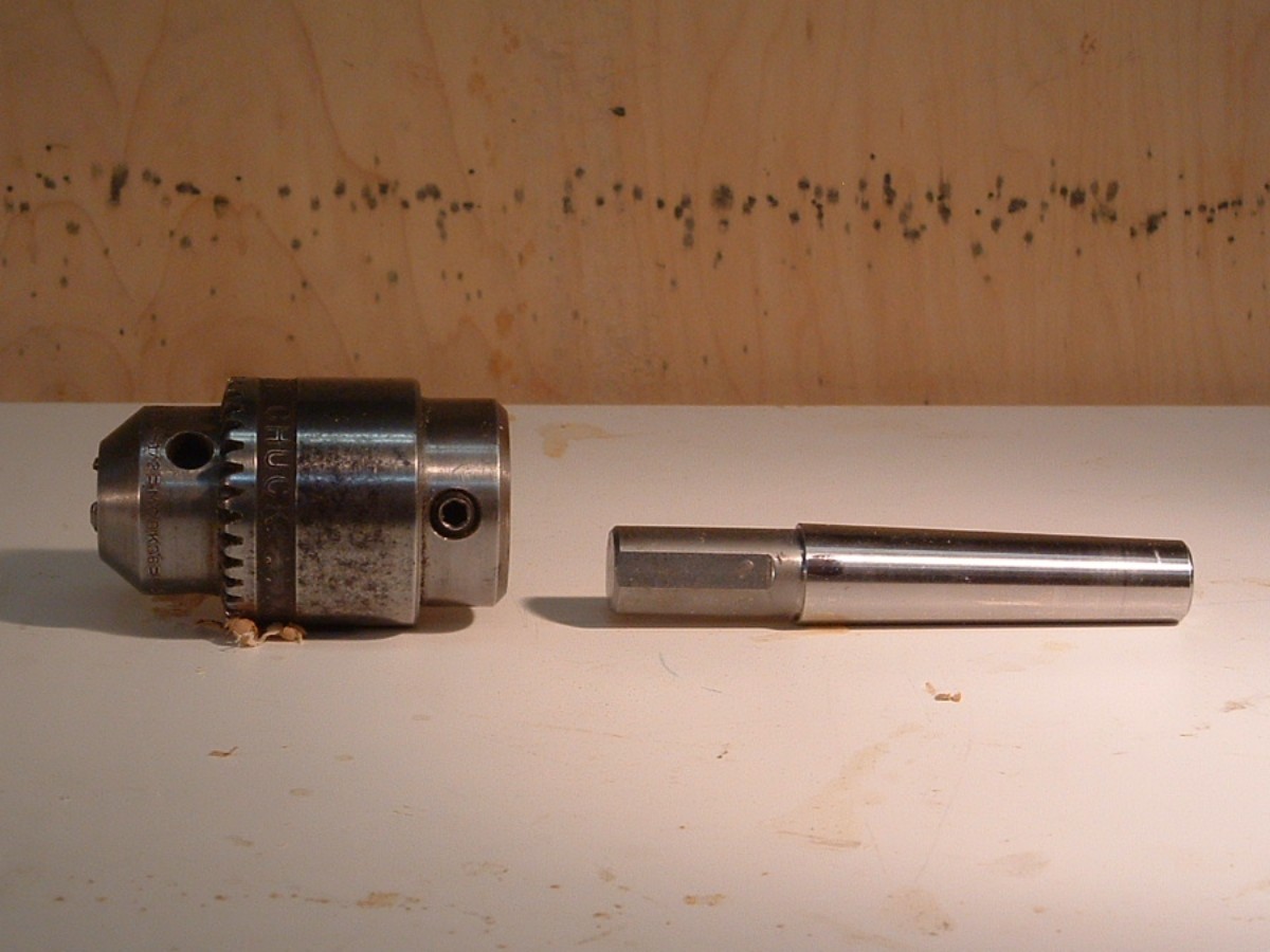

There is also a lathe arbor that is 5/8" on one end and #2 Morse taper on the other, that lets you mount things that normally go on the spindle in the tailstock instead.
https://www.shopsmith.com/ownersite/cat ... arbors.htm

The Nova Live Center System that Ron showed above not only has a #2 Morse tape shank -- it also has a #2 MT bore in its nose. That's how the various accessory tips mount.
The Shopsmith tailstock chuck arbor has a #2 MT shank, and a 5/8" OD nose that will accept any Shopsmith spindle-mounted tooling. The problem is, the Nova live center's #2 MT nose bore is shallow -- less than an inch deep. So you'd need to cut the tailstock arbor's MT shank down to about 7/8" long. It would still engage most of the depth of the MT bore in the Shopsmith tailstock, however, so this modification probably wouldn't limit its usefulness.
