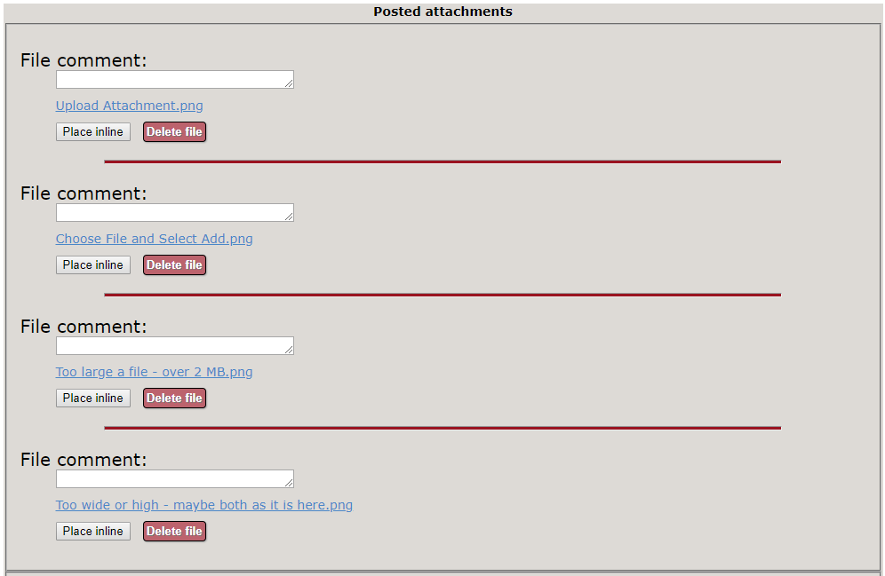

Attaching photos: It is a two-step process.
First you have to Upload a file by selecting it then attempt to upload it allowing the website to validate it’s not too large in size of file.
If it is acceptable, you can then Add it using the Add button.
Upload Attachment.png (4.98 KiB) Viewed 6427 times
Choose File and Select Add.png (7.48 KiB) Viewed 6427 times
(the maximum upload size is 2 MB.)
It will fail if it is too wide or too high in pixels (at most 2050 pixels wide and 1180 pixels high).
It will tell you it is over size if it is. It could be both too big a file, which is the first issue you will have to resolve, only then will it test image dimensions.
Here is an example of the oversize file message
Too large a file - over 2 MB.png (7.8 KiB) Viewed 6427 times
Here is an example of the oversize width and height message
Too wide or high - maybe both as it is here.png (9.14 KiB) Viewed 6427 times
Once it accepts it you can then attach it to your post, which will place it at the bottom.
You also can position your cursor at a point within the text of your message and place each file individually In-line as I have done above and below at the points you want them to appear.
Everett
Multiple files ready to post or place in-line.png (21.48 KiB) Viewed 6427 times
