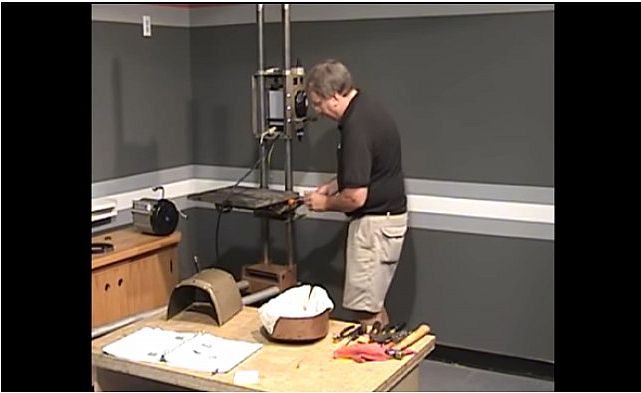

When I installed the PP in my 520, the instructions had the way tubes tilted up and the table mounted just under the bottom of the housing. That way you could tilt the motor out of the housing right onto the table. Same thing when you reinstall the motor. My failure was due to a bad power supply, which was repaired by the manufacture for a total cost of $350.00. I only sent in the power supply and display unit hoping the issue would be in one of those parts.

Yes, I’m a little confused as well. Do you mean with the tubes tilted up as they would be in drill press mode, and the power head pretty much right down on the table? If you can set your unit into the position you describe and post a picture, that would be great. Thanks!

Check out this video. It's the second video. You can skip to 1:20 to see what I'm talking about.
Fred
http://www.shopsmith.com/shopsmithpowerpro/pp_diy.htm
