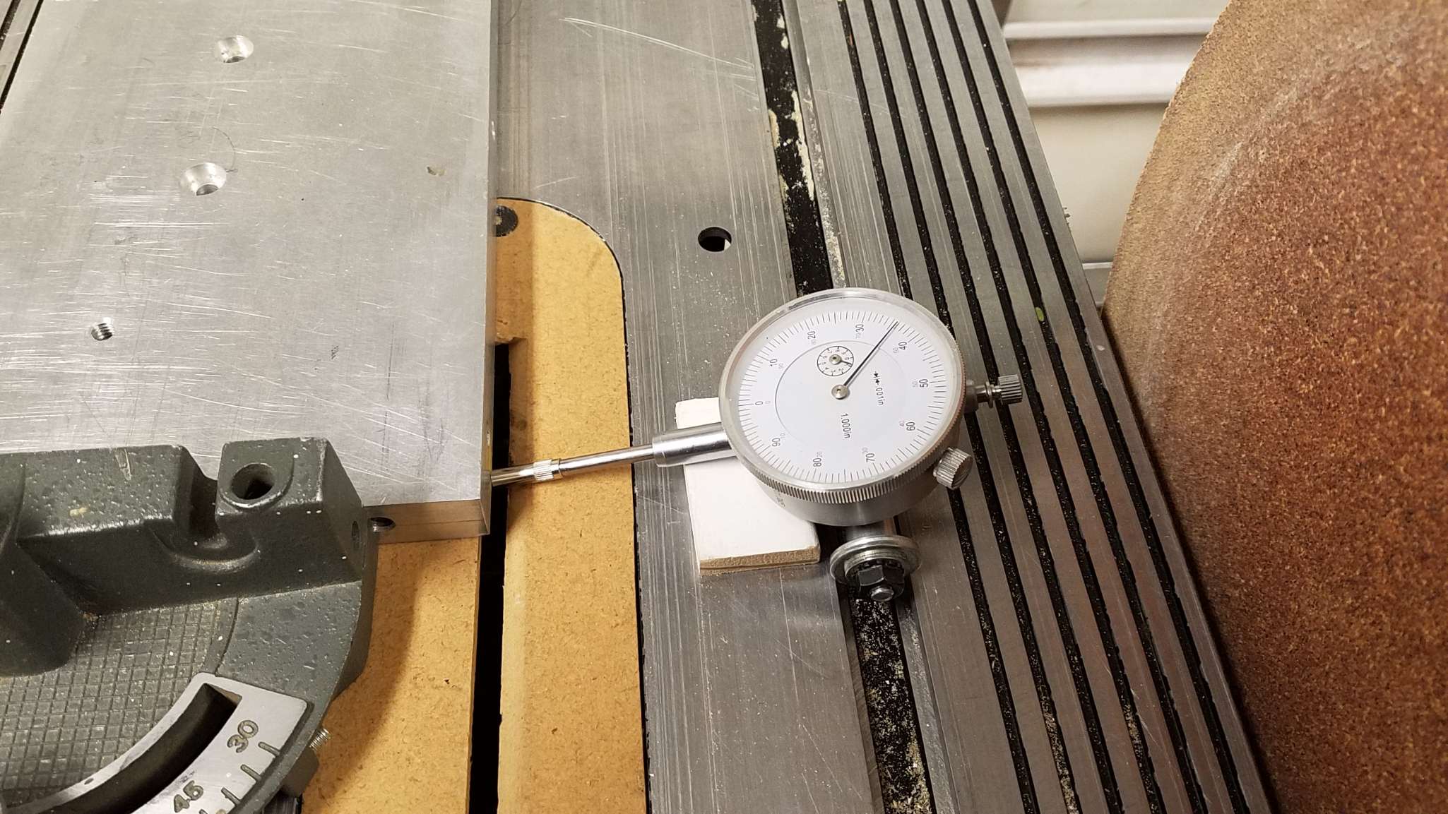

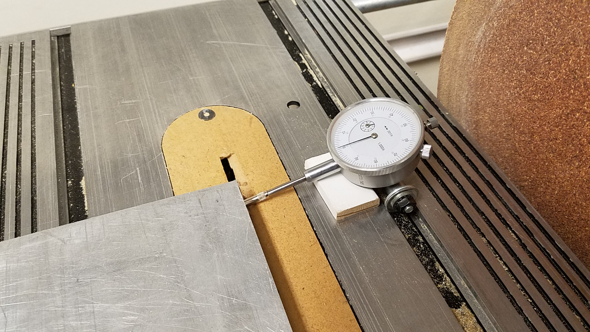

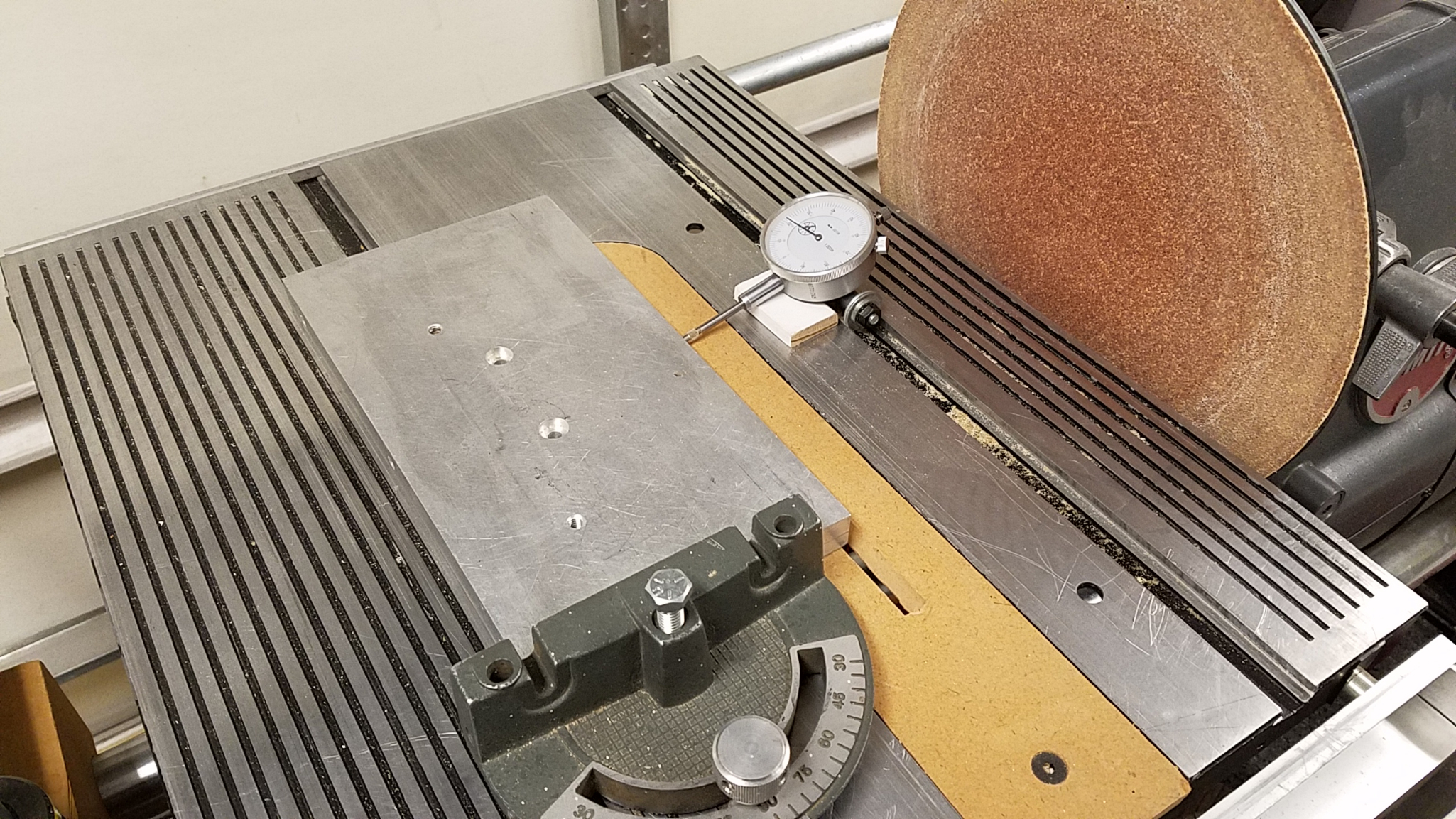

I like your hi tech method but I have revised it slightly.algale wrote:I have used two methods. One low tech the other high(er) tech. Both rely on a good, reliable square and the high(er) tech method requires a dial indiactor.
The high(er) tech method is to put a dial indicator in the miter slot opposite the miter gauge. The indicator has to be able to reach over pretty close to the head of the miter gauge. Clamp the base of a square to the head of the miter gauge with the tip of the blade of the square against the dial indicator's tip. Then zero the indicator. Now slide the miter gauge forward. If the miter gauge head is square to the slot, there should be no deviation in the read out of the dial indicator. Adjust until there's no deviation.
I have an aluminum block that was milled to very tight tolerances. A consider it perfectly square and its' measured length is 11.0". Using it as depicted in the attached photos, the dial indicator shows a difference (end to end) of .038". This translates to about 1/32".
The miter gauge had been "squared" as I stated in my first post to this thread.
Re: Alignments; Main Table and Miter Gauge
Yes, your aluminum block should work very well and eliminates the biggest problem with my method, which is keeping the thin blade of the square in contact with the tip of the dial indicator. I have a woodpecker square with an unusually thick blade that I usually use, but your machined block would be even better!dusty wrote:
Also I usually leave the dial indicator stationary and move the miter gauge. But it should work the same leaving the miter gauge stationary and moving the dial indicator.
I moved the miter gauge. The dial indicator that you see in my photos does not ride securely in the miter track and thus introduces error if I move it.
Changing how I mount the dial indicator (for this application) is one of the many things that I want to do someday. I have miter bars to use but I resist modifying them (for reasons I can not explain).
Notice the reading when the indicator is midway. About 1/2 of the total change. I think this means "linear".

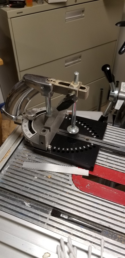

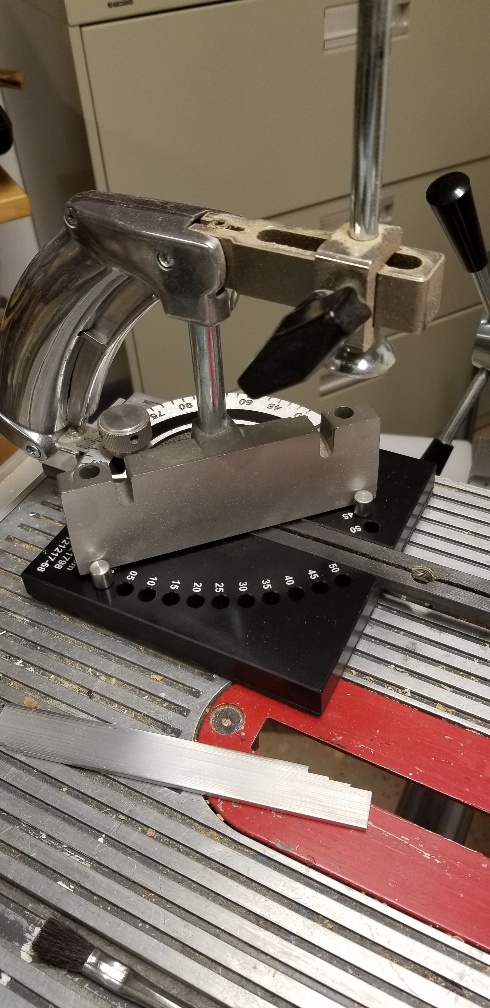

I go for the Miterset. quick, easy dead on. Not cheap, but you will love it. It is made for both the Shopsmith bar or a standard miter bar.
- Miter 90.jpg (200.16 KiB) Viewed 8649 times
- Miter 45.jpg (209.53 KiB) Viewed 8649 times
