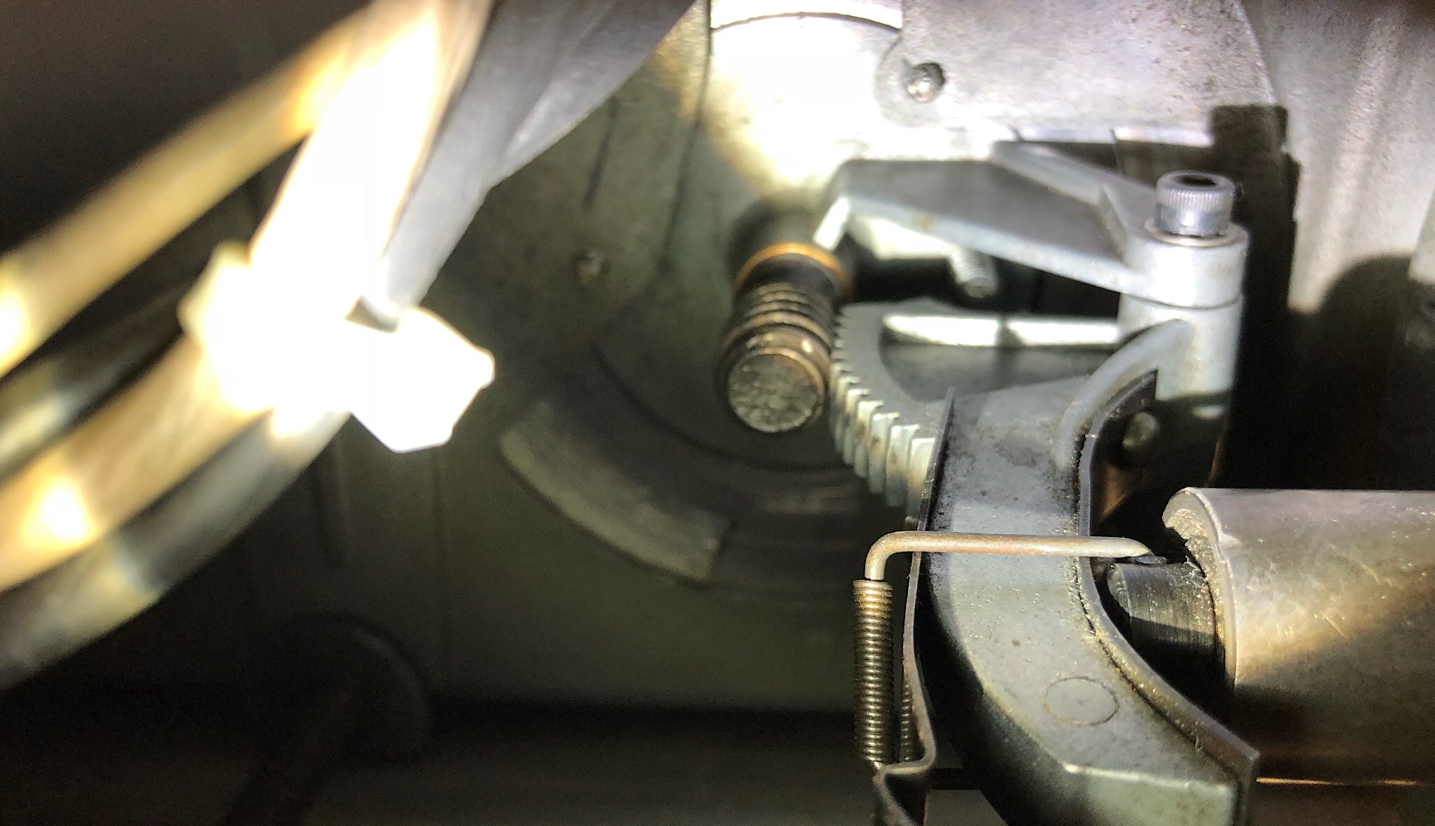

More information... I found this photo in another post:
Notice how the shaft has that smaller black button and bearing between the quadrant and the shaft? With a little loop and spring that goes around the speed quadrant? I don't have any of that. My speed quadrant is coming in direct contact with the shaft, and that's where I see the sparking and burning. So there's the problem.

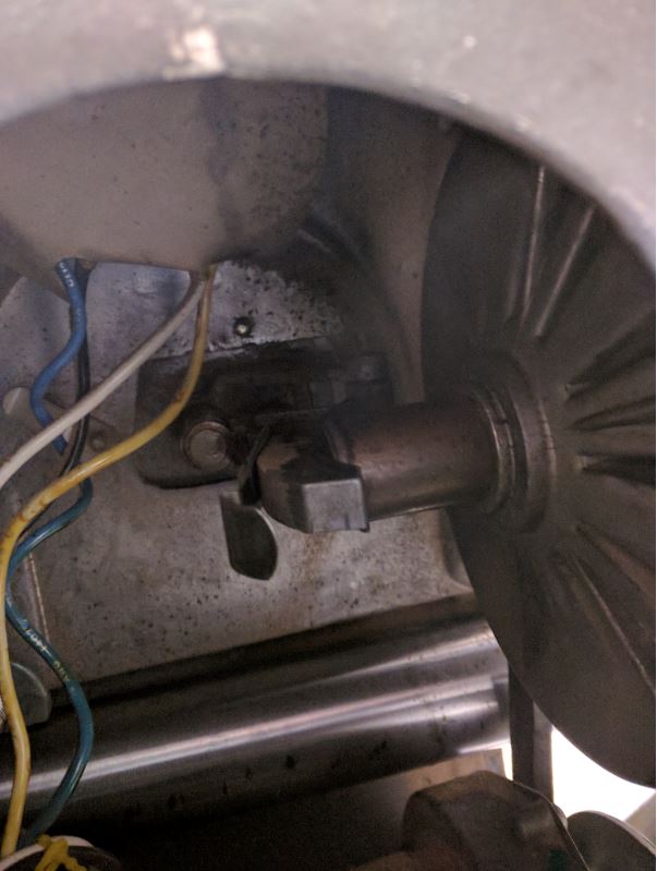

My Shopsmith looks like this:
My Shopsmith.JPG (61.17 KiB) Viewed 8902 times
From Shopsmith's list of common repair parts, it looks like I have to replace the entire control sheave assembly. But I also see Ebay listings for just the bearing, button, and loop. So what I really need to know is, which is more DIY-able? Replacing the entire assembly, or just the button and bearing? What kind of tools would I need, and are there instructions I can look at to see what I'd be getting myself into?

Re: Model 510, Loud Noise as Speed is Reduced
Looking at 'yours', I would say it is not likely you can repair it with those bearings on e-bay.
It is also likely you will need a new quadrant gear(porkchop).
