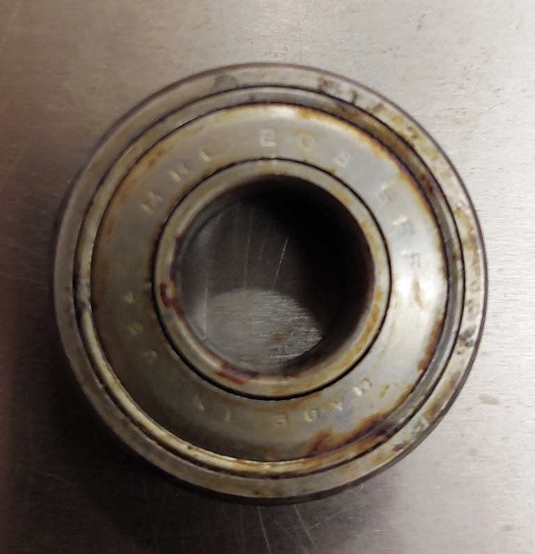

What info do I need to find the bearings, and where can I get them? Took it apart some sawdust, bearing seemed to turn freely??
It seemed the housing was hot not sure the end caps were.

The OEM bearings are MRC 203SFF. They are available probably everywhere. I buy mine from A & W Bearings that apparently has been aquired by Purvis Industries since I last checked. Anyhow, they have the originals for $11.07 each.
https://www.purvisindustries.com/256855 ... mrc-203sff
