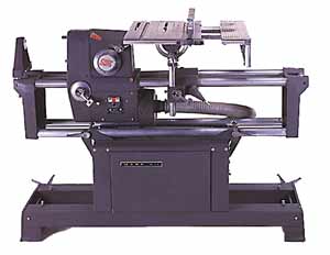

Is this the Mark VII you are looking at?
MARK-VII_SS Inc.jpg (7.93 KiB) Viewed 10159 times

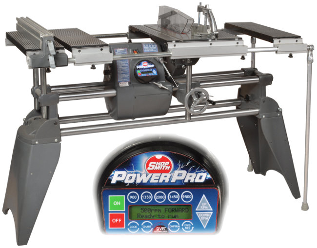

If so I would reconsider which model of Shopsmith you buy. The Mark VII (shown above) was made in the 1960's for only a few years. Replacement parts are all used ones or some that people have recreated and sell on sites like ebay. I would recommend getting a Mark V. Since the Mark V is still in production new parts are available for it. The Mark VII is much bulkier and the only functions it has over the Mark V is reverse (not a common need) and double tilt for under-table routing and shaping. Both of these functions can be added to the Mark V with the Double Tilt Upgrade and the PowerPro headstock. These upgrades will cost you a lot but the Power Pro Headstock will give you a wider speed range with reverse. The same Band Saw will work on either machine along with other SPT's. If you were looking at it as a collectors item I would say go for it but as your only machine, no.
Now that having been said if this is the Mark 7 you are looking at and the price is good than go for it. New it is $4279.00.
This is what you can upgrade a Mark V 520 to with the double tilt and powerpro.

There is confusion about the Mark VII and Mark 7 models. The Mark VII was made in the 1960's but it has marking on the machine that say both Mark VII, the more visual marking and on a small plate Mark 7. The 1960's model is generally referred to as a Mark VII. The new Mark 7 was released in 2010 and follows the Shopsmith philosophy of having older machines up-gradable to newer Mark versions. The new Mark 7 uses many of the same parts as the Mark V. It's two main differences from the Mark V 520 is the PowerPro motor in the headstock with some different internal headstock parts and the Double Tilt which is a modified base and arm from the Mark V. The main differences of the Mark V versions is the table/fence systems of the original one the 500, the 505 (same as the 510 w/o floating tables), the 510 and 520. The Mark 7 uses the 520 table/fence system. There has been many changes to the Mark 5 from it's introduction in 1954 but even those first Mark 5's can be upgraded to a Mark 7. Note the use of Mark 5 and Mark V. In 1980 the Shopsmith itself had the model markings on the machines vent/serial number plate change from Mark 5 to Mark V although Mark V had been used on printed materials for several years prior to that.
