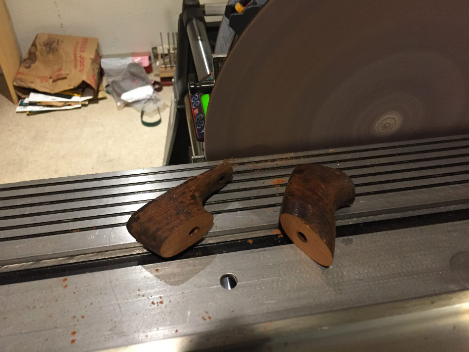

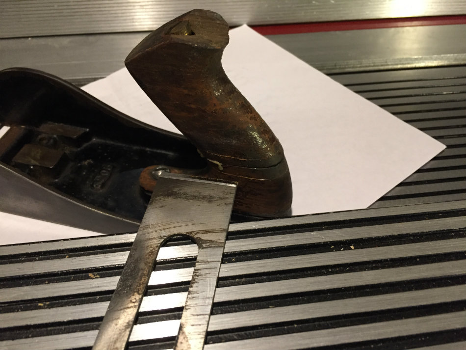

Here I have offset my 510's Main Table and Extension Table a couple of times, and used a sharp blade to mark a busted plane-tote exactly horizontally:
Those markings aid in taking the busted halves to dead-flats on the sander:
Dead Flat Halves.jpg (110.58 KiB) Viewed 4240 times

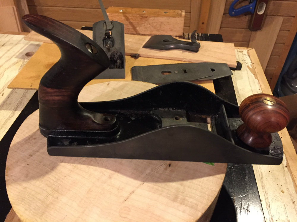

Typical outcome will be like the following;
Happy woodworking / tool-hoarding!

How do the handels hold up afterwards?
Paul B
nuhobby
Posts: 2366
Location: Indianapolis
Re: Using $3G Shopsmith as a fine Height Gage
Post by nuhobby »
Paul, I've done a number of these and they hold up great, provided the glue and clamping is done methodically. My main jack-plane has a 8-year-old splice like this.
I used to make complete new rear totes, but preserving the original profiles with a splice piece is very satisfying as well.
