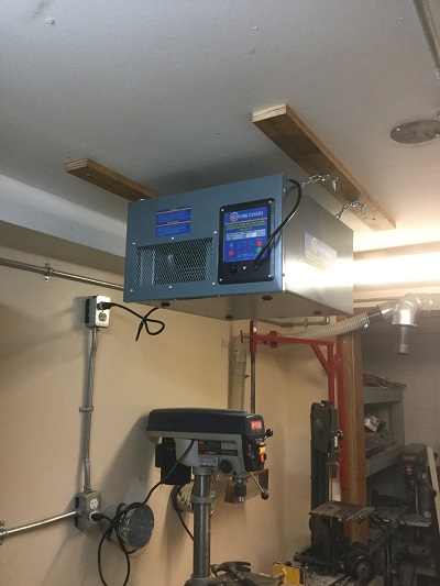

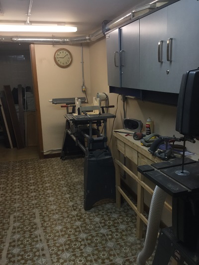

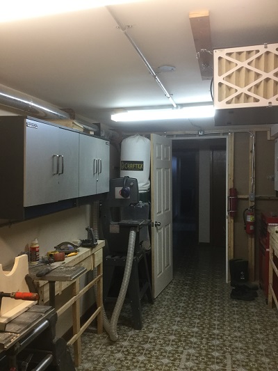

Hi everyone,
I just joined the forum and was wondering how to solve a problem with the dust under my mark v was built in the 1980’s
I am using in in my basement of the house, and bought a overhead dust extractor too help.
Ideas would be appreciated,
Dennis

welcome to the forum and thanks for the pics.
I see that you have a shop vac, you can attach to your SS?
It looks like you might need a longer hose to reach the SS
I have a shop vac that I use, but I like using a leave vac that I made to connect to my SS and use it it collect the dust that is on the floor
good luck and enjoy your SS

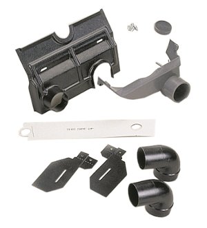

It was replaced by the one shown in the picture belowIt has less open space under the table but has only an 1-1/4" hose attachment. This one was upgraded to two 2-1/2" hose attachments and provides better air flow. You can still buy either the upgrade parts or the complete upgraded guard system. Both are shown below.
That being said some blade guard systems work better than others at containing dust and directing it to dust collectors. Most of the Mark V with the original 500 table system in the 1980's came with the blade guard set for dust collection shown below.It leaves a lot of open space below the table for dust to escape.No matter what you do there will be some dust on the floor. Just the nature of woodworking.
