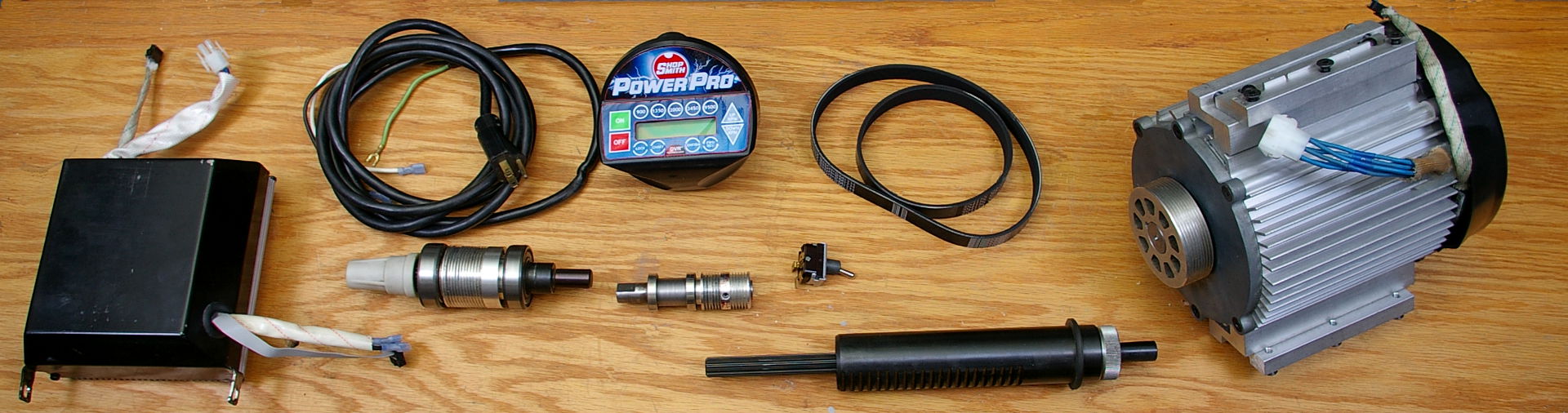

I have neither a PowerPro nor have I done an upgrade, but could it be because you have a type "B" headstock with a toggle switch, and not a type "C" headstock with the red rectangular safety key switch that was introduced in 1991? From the "History" section of the Mark 7/ Mark V page:
1991 -- “C” Headstock
1991 Mark V Models were introduced with the “C” Headstock featuring a Red Safety Key Switch.
EDIT: I just looked at what is included in a self-install upgrade kit, and I think I now see your delimma. The short video does not specifically mention a switch as being included, but it sure looks like a toggle switch in the picture. I will have to defer to someone with first hand experience.
- power_pro_components_l.jpg (213.45 KiB) Viewed 10308 times

Just a curious anomaly in the upgrade photo.... Zoom the picture to examine the splines on the quill. I have always found it odd they didn't use a photo of the poly-v version of the assembly and actually used an old Gilmer drive quill assembly in the photo for what's in the Power Pro upgrade.br549 wrote:I have neither a PowerPro nor have I done an upgrade, but could it be because you have a type "B" headstock with a toggle switch, and not a type "C" headstock with the red rectangular safety key switch that was introduced in 1991? From the "History" section of the Mark 7/ Mark V page:
Sorry for the diversion.
