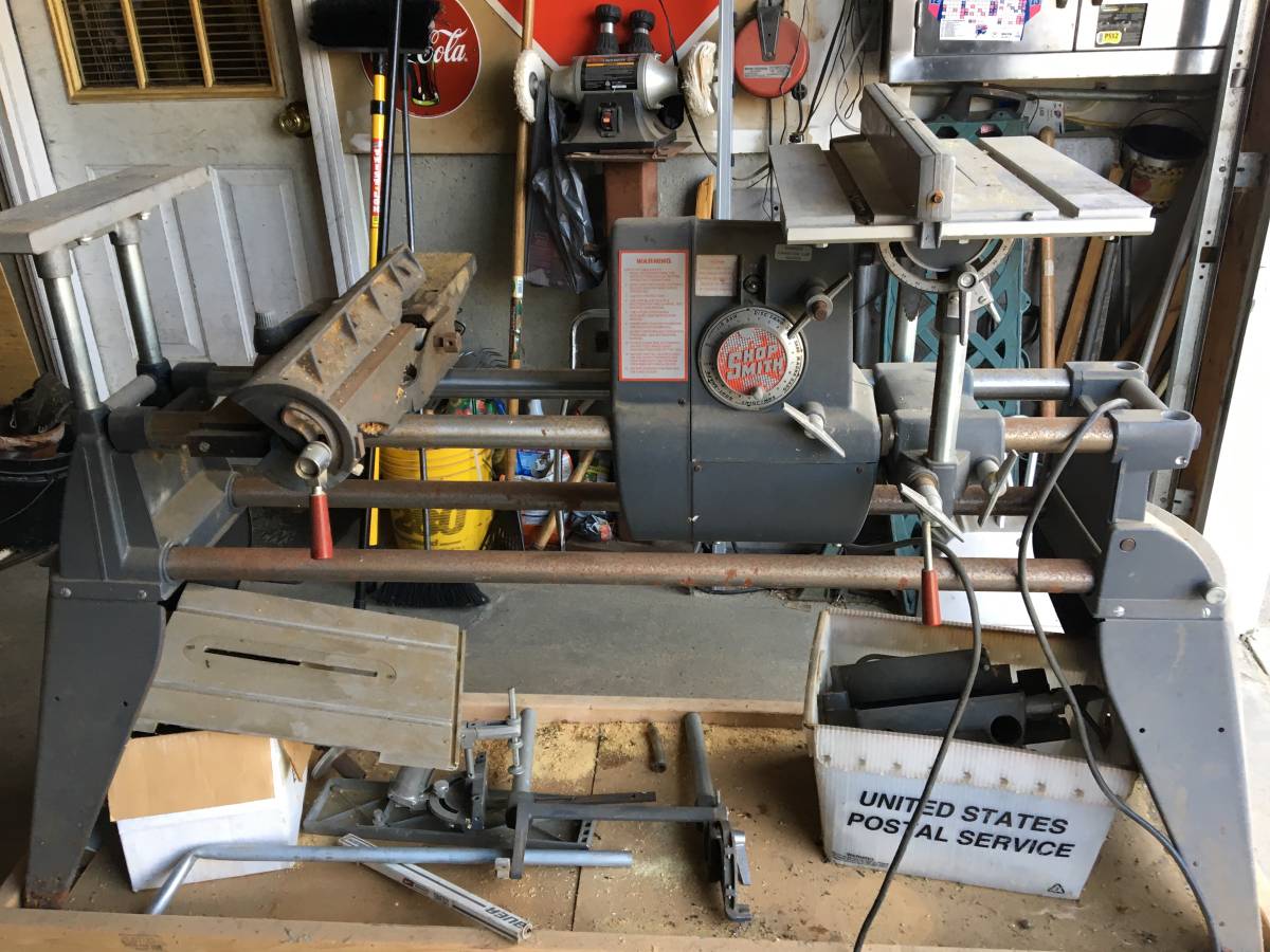

br549
- Posts: 657
Re: motor update in 1956 Greenie
All of Everett's suggestions were good, but in case you haven't thought about Craigslist, you might try that too if you truly need a replacement. Availability and costs vary greater depending on region. Also, search using term "Shopsmith" and as 2 words "Shop Smith". I found this when searching using 2 words which didn't show up when searched just as one word. This machine is about the same age as mine (mine is 1980), and I would never think of selling mine for this little. If you are willing to drive a little further, expand your search range and who knows what you will find!
https://westernmass.craigslist.org/tls/ ... 36534.html
- 00W0W_cPGXAd99UXt_1200x900.jpg (150.92 KiB) Viewed 11137 times
