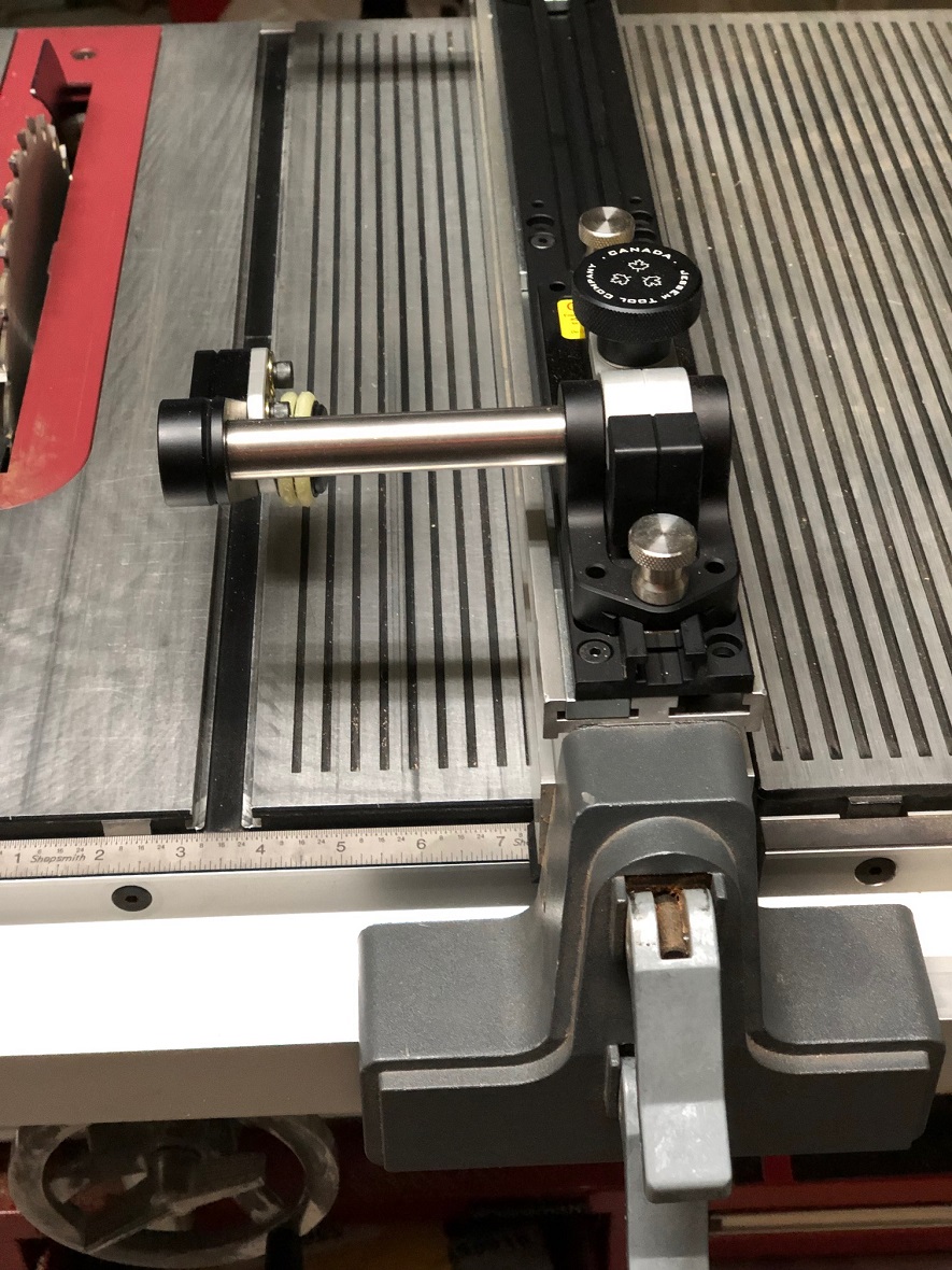

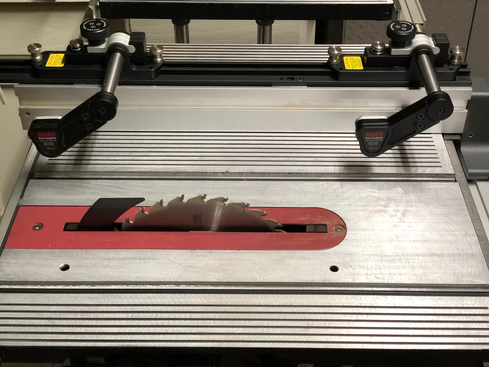

I installed the Jessem Clear-Cut guides on my Shopsmith 520 fence this morning and did a test run. It worked great on ripping some 1 1/2" thick cherry that is 6' long. The rollers are canted at 5 degrees so they pull the board into the fence. Pics below are my preliminary mounting, but I need to revise it. The T-track from Jessem is an almost perfect match for mating to the centers of the T-track on the Shopsmith 520 fence. I used Shopsmith p/n 514491 sliding t-nuts to secure the Jessem t-track. Unfortunately, to secure into both T-tracks (left and right) on the Shopsmith 520 fence, I will need to drill and tap some new holes in the 514491 sliding t-nuts. I will do that next, but very impressed with the initial test run for this and I believe this will make long ripping much safer. Pictures below for anyone interested.

Have them and love them! In fact I was using them yesterday.
I installed them just as shown in your picture using the shopsmith t-nuts on only the left track of the rip fence. I think you will find it unnecessary to add t-nuts to the right side.

Somewhere I posted about them. I think the only thing I had to do was grind a tiny bit off the allen head screws, which otherwise were bottoming out in the t-track.

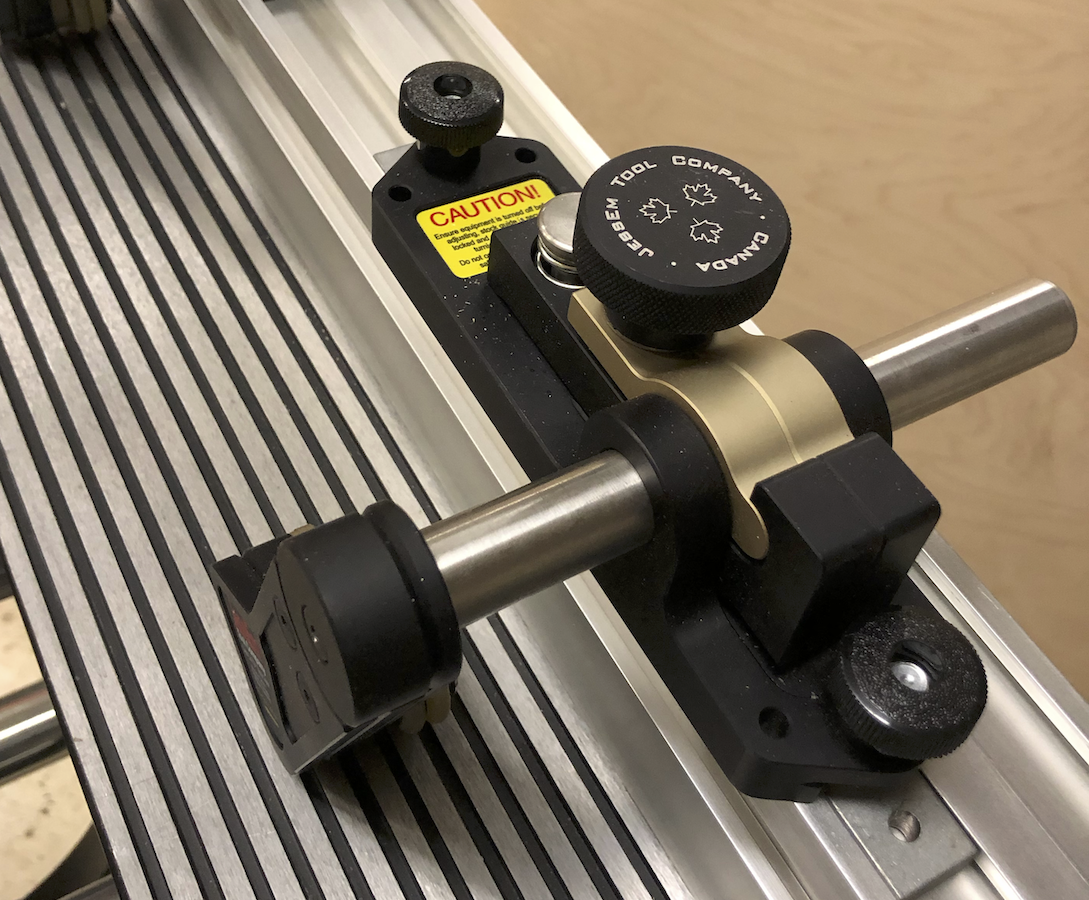

I made a mounting bracket from aluminum. I love the Jessem Guides! Two brackets one for each slot on the fence.
Jack

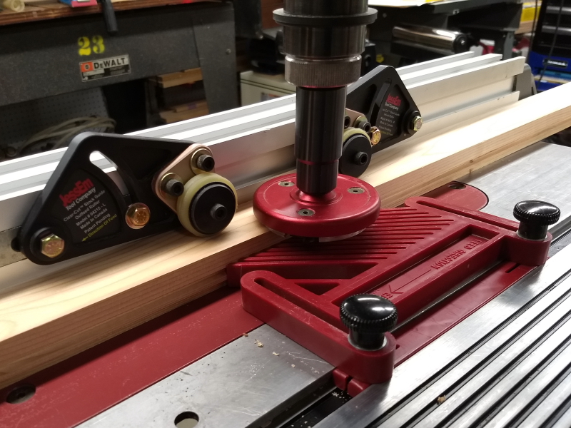

Ben, here’s a post in which I described doing exactly that:
http://internet.shopsmith.com/ss_forum/ ... 15#p249315
Although I mounted the router guides directly to the side T-slot on the 520 fence here, it would be easy enough to make up a more versatile mount. A board that mounts flat to the top of the 520 fence, via transverse T-slots, would just about do it. Maybe with a T-track attached to the blade side for the router guides, if you want to be able to change the guide spacing, or if you just don’t want to fiddle with changing the bolts when you move the router guides from one machine to the other.
Jessem pretty much had to design all that nice adjustable bracketry for their tablesaw guides, as it is intended for typical cabinet-saw fences that don’t have any built-in jig-mounting features. But the T-slots already designed into 510 and 520 fences give you a much more versatile starting point.
BTW, I replaced the standard hex-head bolts from Jessem with proper T-bolts from Woodcraft, and I like them a lot better. Now I can use an Allen key to really lock down the knurled clamp knob, without damaging the T-slot on my router fence.

claimdude wrote:I made a mounting bracket from aluminum. I love the Jessem Guides! Two brackets one for each slot on the fence.
Jack
Nice idea using aluminum bar stock and routing it to mount in the Shopsmith T-track. Thanks for the suggestion.

I took the guides off the Jessem rail and mount them directly to the 520 fence with T-bolts.
