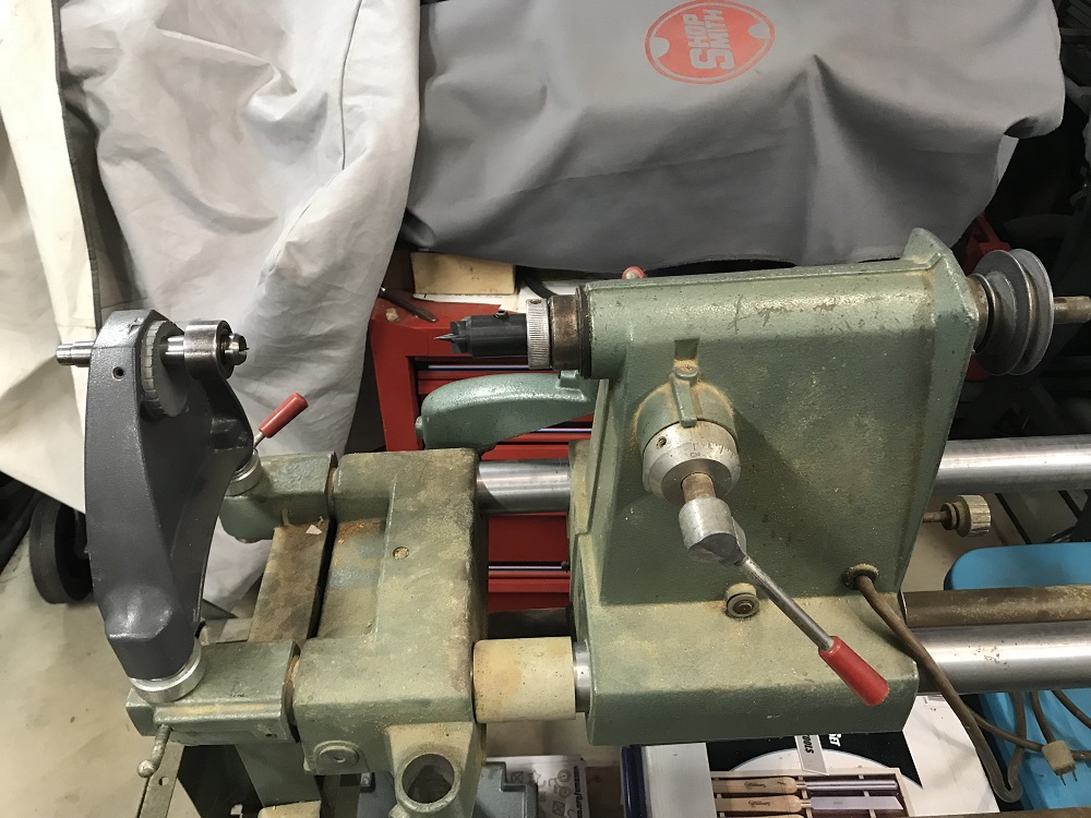

Can you confirm weather the Mark V tailstock will fit on the Mark 2. I'm trying to upgrade the lathe accessories to a Nova G3 chuck system and want to add a "live center" (tapered) at the other end to fit into a tailstock. I've been told both that the Mark V tailstock will and won't fit. Do you know if it will fit the Mark 2. Thanks.
- Posts: 4555
Re: Mark 5 to Mark2 Tailstock
Here is confirmation. In the picture below is my Mark 2 (which is awaiting restoration) with the tailstock from my 2001 Mark V 520. As you can see the Mark 5/V tailstock will work on the Mark 2. All Mark 5/V tailstocks are the same from the Greenie's to today. Even the new Mark 7 uses the same tailstock. The use of the tailstock block that attaches to the extension table for the Mark 2 was one of the cost saving designs used to bring the price down.
Using the Mark 2 for a lathe has an advantage over the Mark V. Since it uses changeable pulleys getting larger pulleys that will fit on the drive spindle will reduce the speed. See the chart in the PDF attached for pulley speeds.
The disadvantage of using the Mark 2 for a lathe is it's lighter weight.
