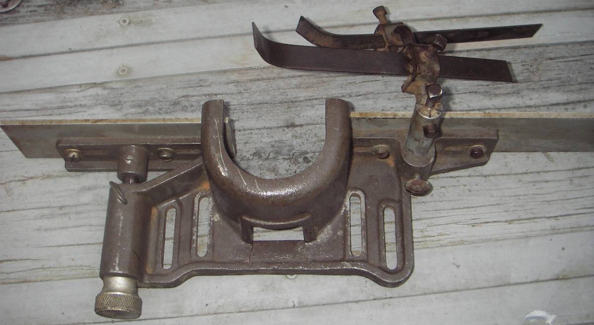

Anyone have any idea what this is? S/N 1921 on Craigslist in Texas. Certainly looks like a shaper fence as advertised. But it doesn't look like any Shopsmith Shaper Fence I have ever seen. Here is the ad:

I don't know what it is from but it is definitely not Shopsmith.

As John said not a Shopsmith part. There are several items in the ad that are not original Shopsmith parts for S/N E-1921 as well as what looks like a homemade dust collection attachment.

I thought it was a bird feeder.chapmanruss wrote:As John said not a Shopsmith part. There are several items in the ad that are not original Shopsmith parts for S/N E-1921 as well as what looks like a homemade dust collection attachment.

Re: Shopsmith 10E Shaper Fence?
Like the Mark V quill advance handle!
Miter gauge, rip fence, main table definitely 10E.
Tailstock 10ER.
1-8 speed changer.

It just shows the legacy of the SS. There is no reason to change things that don't need to be changed.JPG wrote:chapmanruss wrote:As John said not a Shopsmith part. There are several items in the ad that are not original Shopsmith parts for S/N E-1921 as well as what looks like a homemade dust collection attachment.
Tailstock 10ER.
1-8 speed changer.
Also notice that the speed changer is 1-8.
Obviously the posters "sources" have no idea about this machine. To quote from the post...
"Info I've gathered thus far is that this is a 10E model or 10-Experimental. One person said it was probably made between 1952 to 1955 however, I am told that this unit has Magna written on it which is the OEM from the 60's. "

I have given him the correct information on those errors in his posting. I do not believe the seller has been here on the forum.
