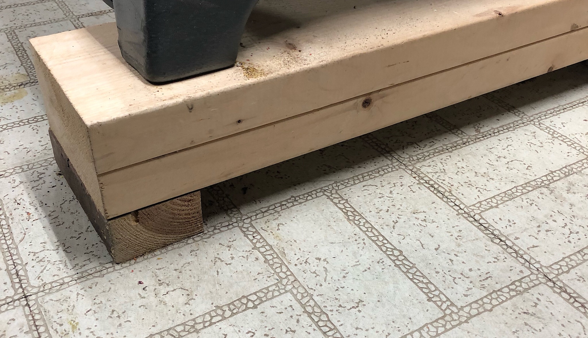

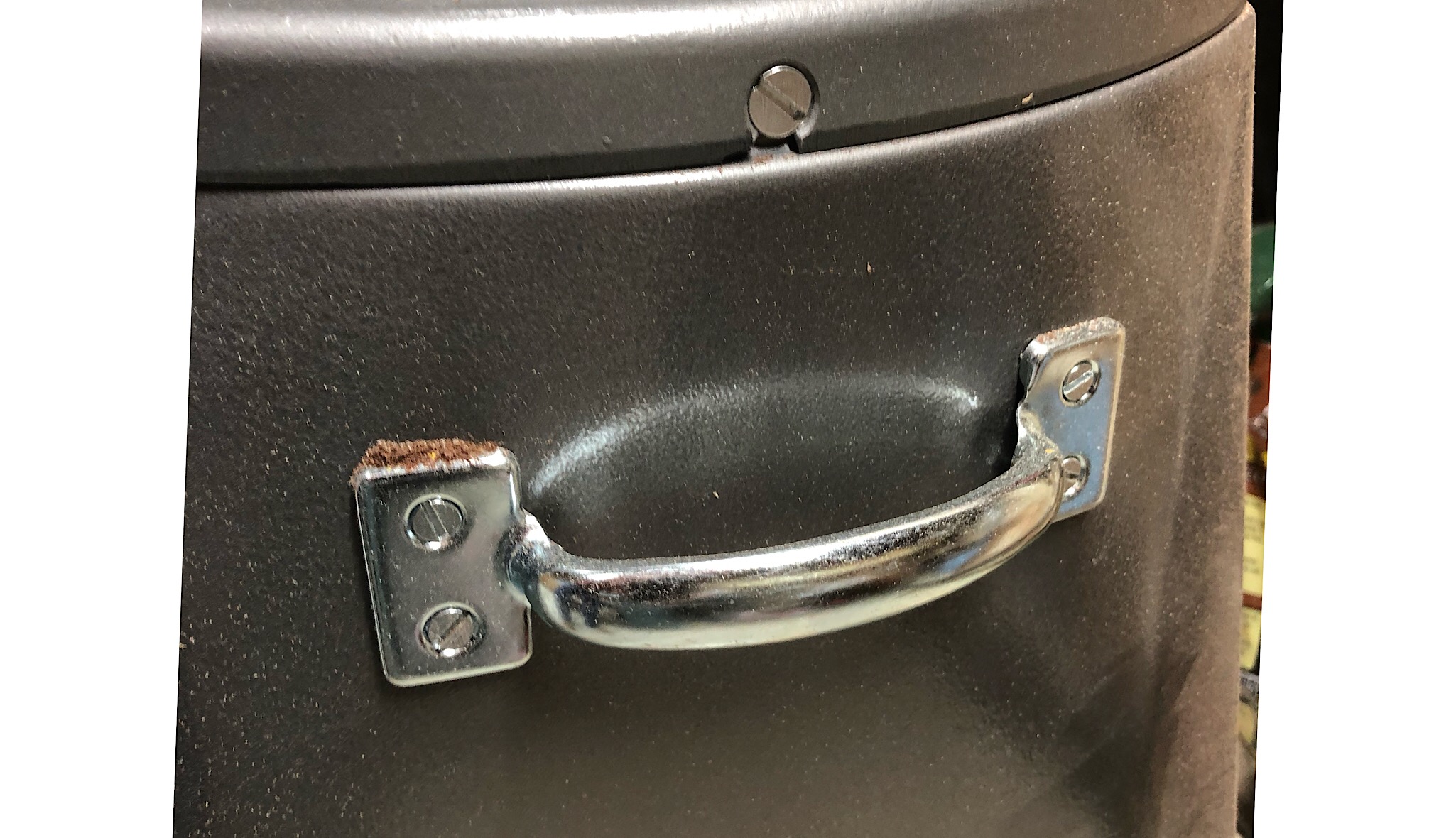

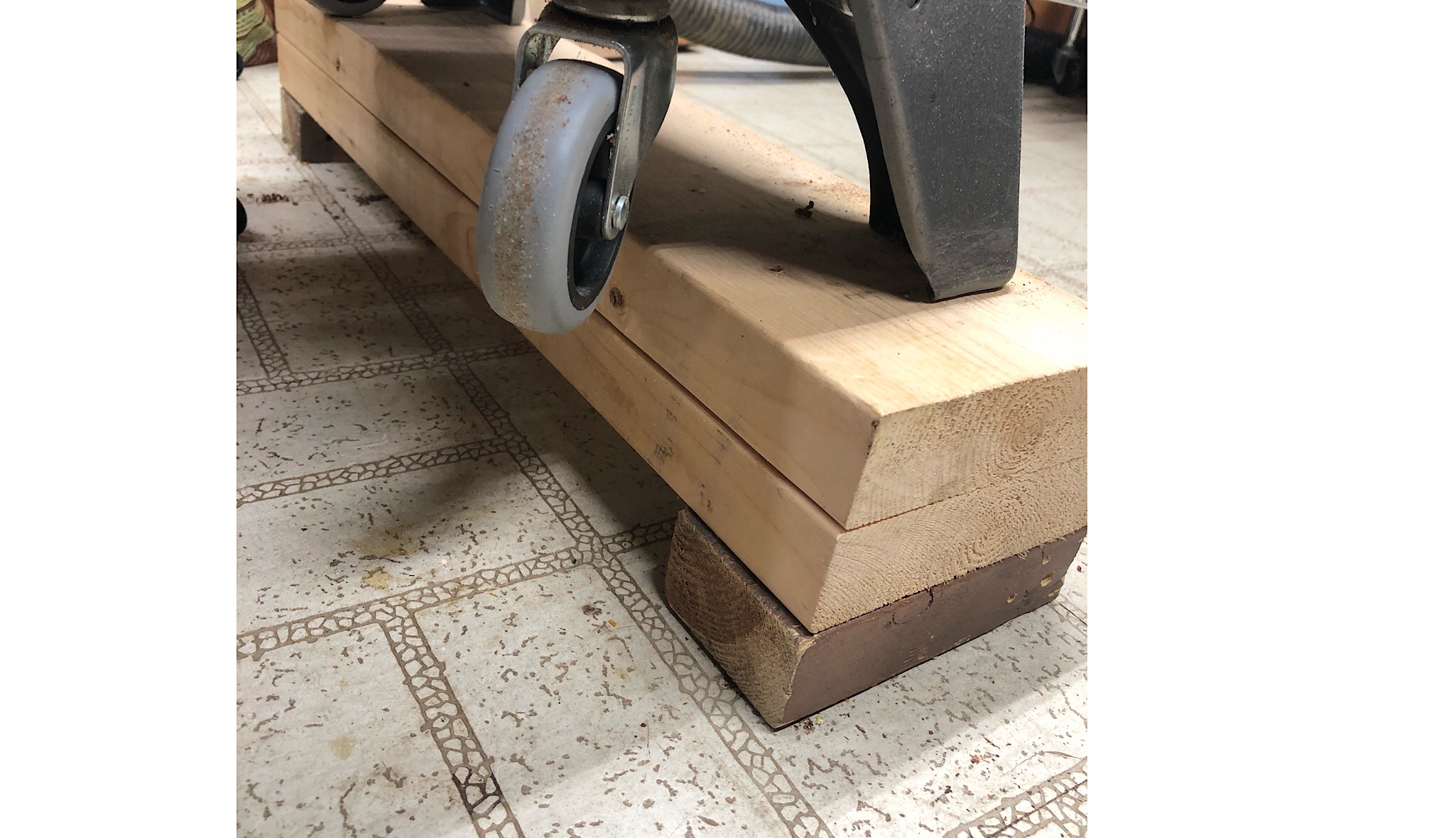

This is what I did. Used 2x6s. The pads on the bottom are to compensate for unevenness of the floor. I put these handles on the ends to help lift the SS on and off the blocks.
I’m 6’ 2” and this added 4 1/2” helps with the neck and back issues. Doesn’ prevent, just helps.
I check periodically to ensure the SS isn’t wobbling off the platform.
