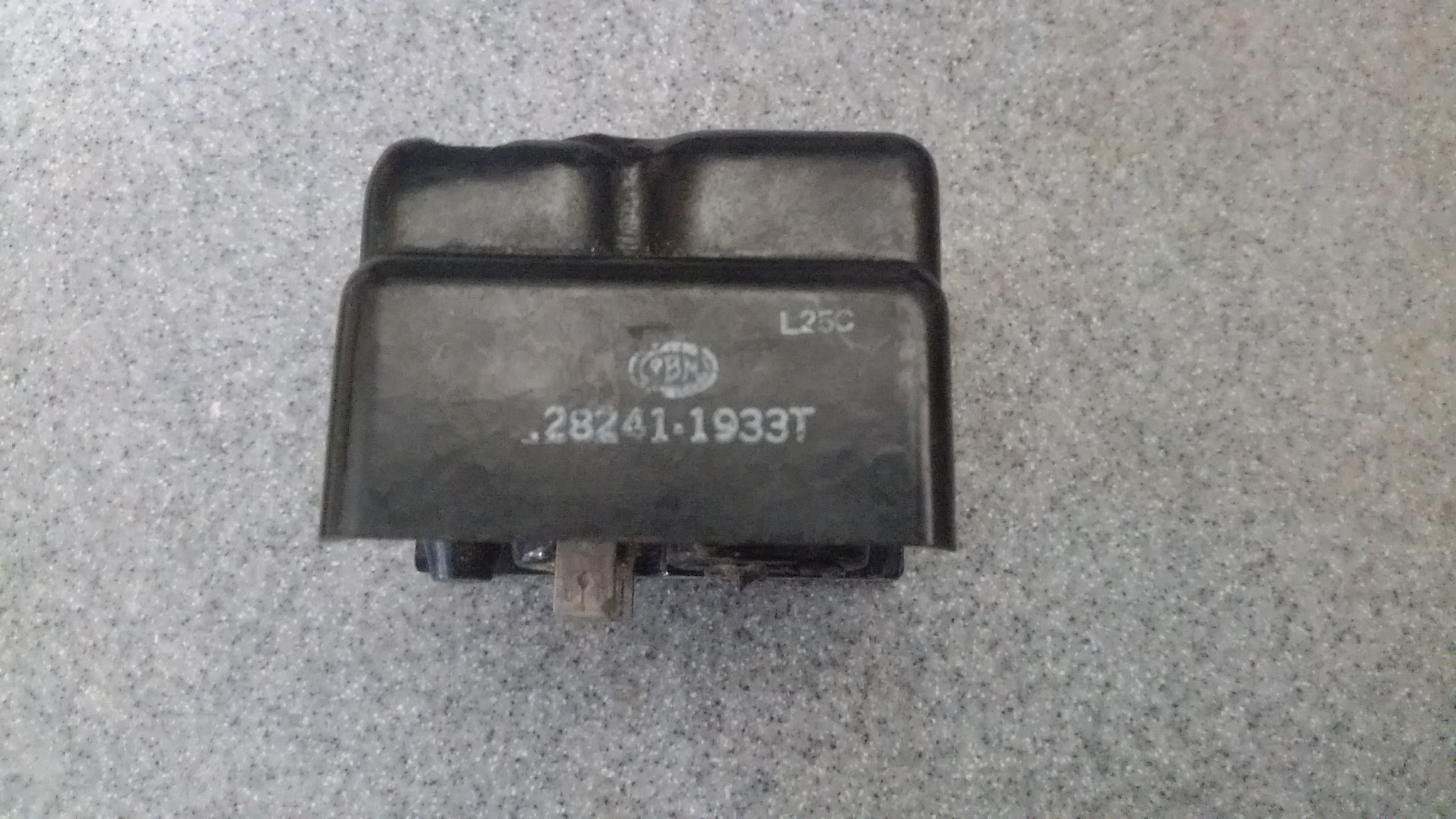

I have an old mark vii with an AO Smith motor that had a bad start relay. I replaced it with a new supec. It starts ok now but I'm not entirely satisfied with it.

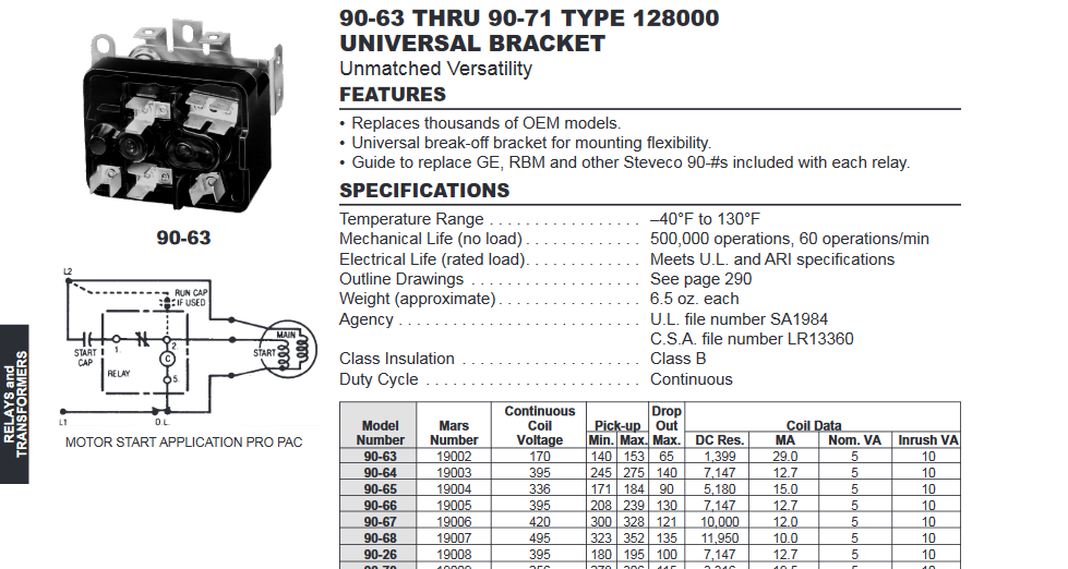

I'm investigating replacing it with an oem or one that I can cross reference but I can't find my part # anywhere online. There are alot of potential/start relays on ebay. but I don't know exactly what is comperable spec-wise to my RBM ?.
I've attached a pic of my old relay and a pic of a White-Rodgers relay part #'s w/ specs.
thanks, lenny

I mispelled it. I replaced it with a Supco apr5.

As far as my original question goes, with your understanding of electricity and motors, is there any relay on the White- Rodgers chart I posted similar to what ths motor would need; such as the 90-63. If not, do you know what these specs should be for this motor?

The reason for measuring the voltage developed when it is running full speed is to determine a reliable setting for when the relay picks and opens the start circuit. You want it to disconnect the start circuit when it APPROACHES the run voltage(slightly below the run voltage). I am assuming one mark is reliable.
There is no way to adjust the drop out voltage(as it coasts down to a stop). I believe the circuitry is sluggish in that regard and interferes with starting when restarted too soon. I am somewhat surprised that it works at a 220 setting. I would not have expected the voltage to be that high.
With a run voltage measurement, we stand a better chance of selecting a white-rogers relay that will work.
