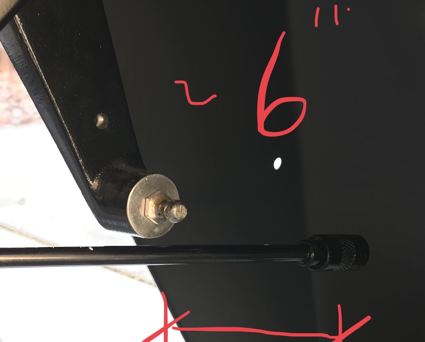

Wes7373
Posts: 50
Joined: Sat Jan 07, 2017 4:01 pm
Re: Length of lift assist strut
Post by Wes7373 »
Thanks, Bill. Mine is about 17” in the horizontal position strut to strut.
John,
I’ll post some pics in just a minute, when I figure out how. Question: If the Lifes are installed in the horizontal position, wouldn’t that mean the cylinder is under compression when installed?

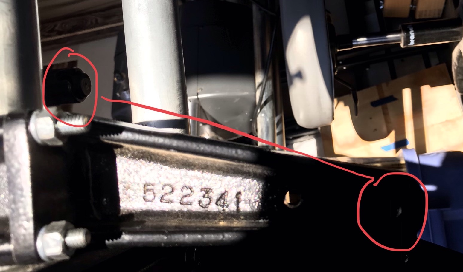

Post by Wes7373 »
Horizontal position - too long to attach
Wes7373
Posts: 50
Post by Wes7373 »
Vertical position- strut short of mount (pic sideways)
wa2crk
Posts: 3080
Location: Leesburg, Fl
Post by wa2crk »
WEs
The machine must be put into the vertical position (drill Press position) and I think that then there will be enough room to attach the cylinder. With the machine in the down position and the cylinder expanded I believe that the lift rod will be too long
Bill V.
Wes7373
Posts: 50
Post by Wes7373 »
Bill,
the pictures didn't make it easy to see, but in the vertical position, the strut, at full extension, is several inches short of the mounting points. I wonder if i have the wrong strut.
Wes
