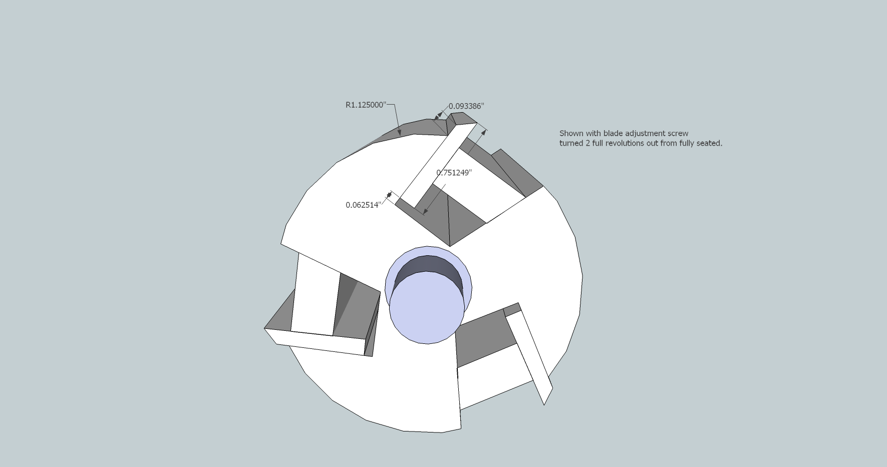

Re: Proplaner Questions
A Cutter Head with blade and wedge.png (50.79 KiB) Viewed 14694 times
A Sketch of my cutter head.
The blade is thicker on the bottom edge than it is otherwise. Reportedly a safety feature to prevent the blade from being thrown from the cutter head.
