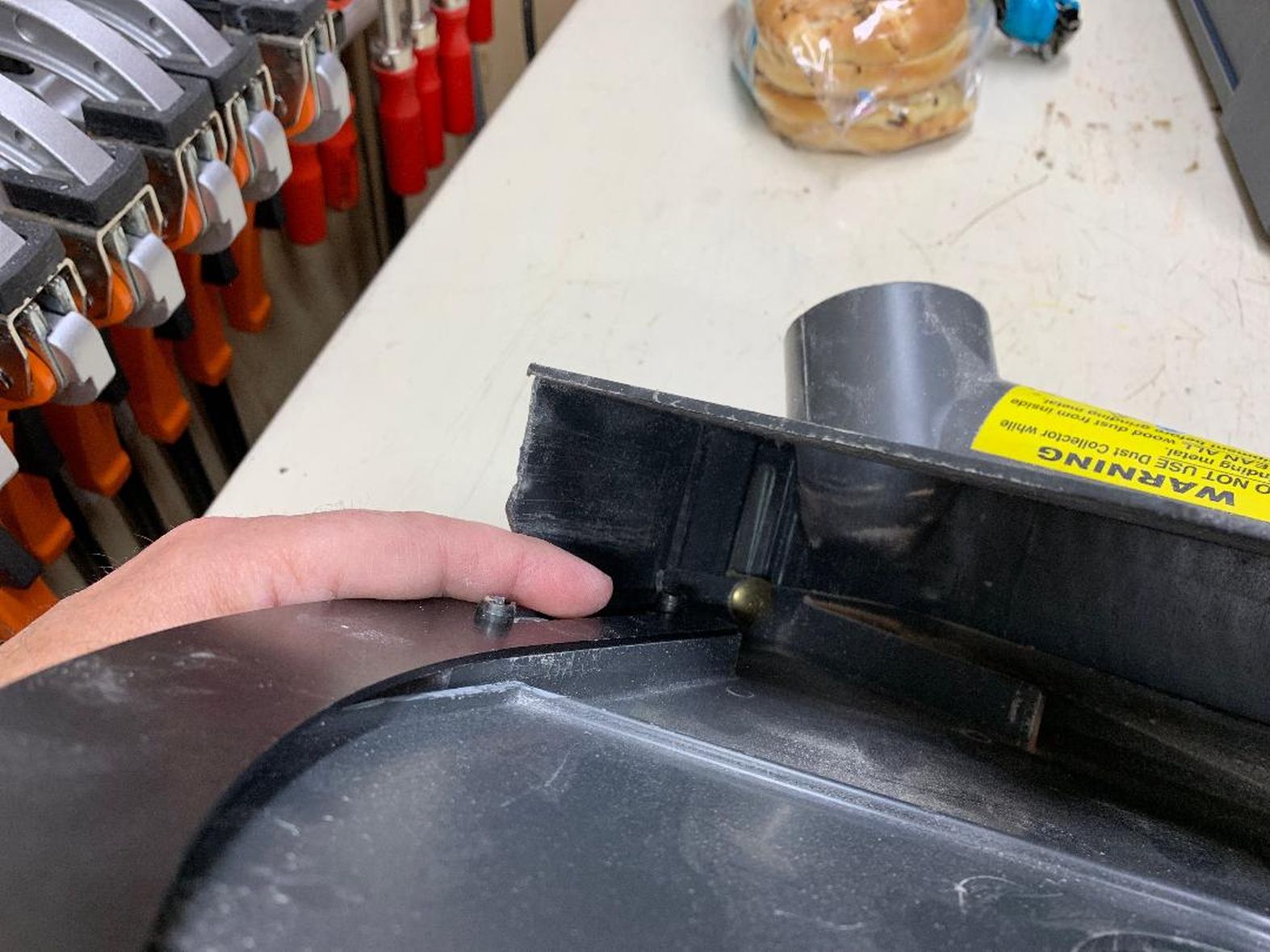

Re: Riving knife alignment problems
Shot a few pictures of my guard that might help to spot the issue with yours.
This is a pretty simple arrangement, the knife just slides in and the two pins align it vertical and the other part screws closed clamping it. But since yours has issues there are a few thing that could be issues.
I would first check to see that the back of the lower guard is reasonably flat with a straight edge. I would not expect it to be perfect up if there is some bow or bend of say over 1/16" that is more then I'd like to see.

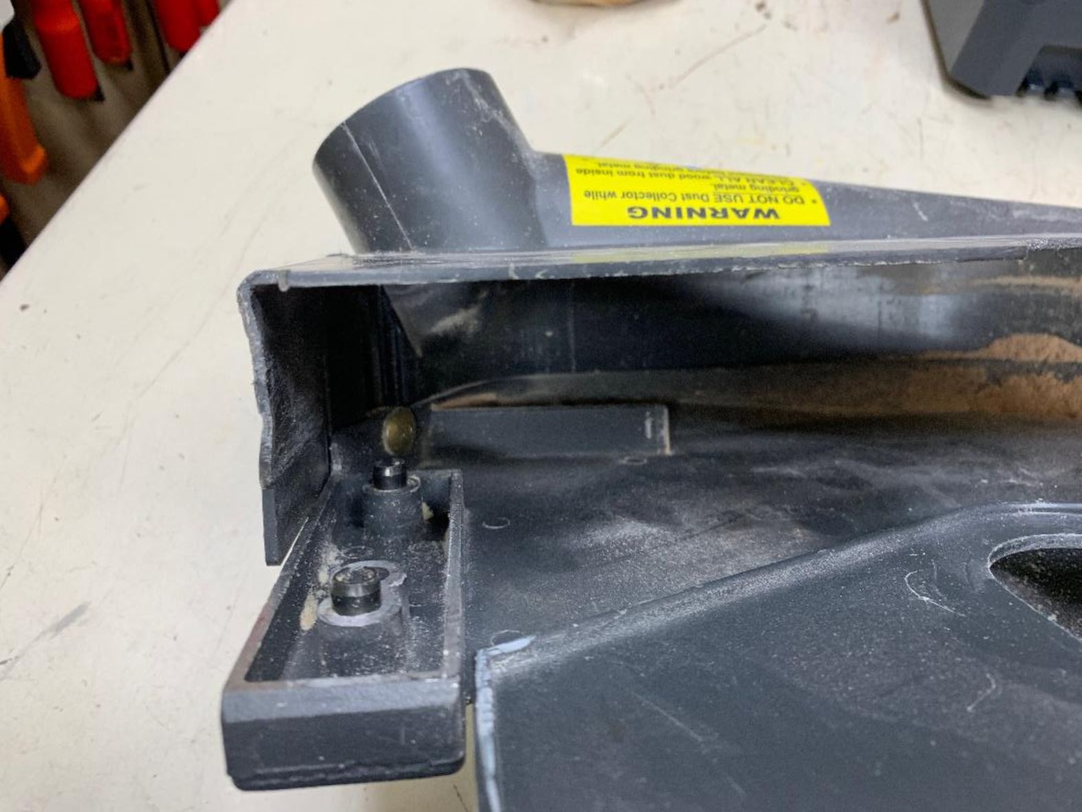

Here are the pictures of mine, in the first one you can see the two pins and you can do a visual inspection of the area where the knife will touch, including near the two pins to make sure there is nothing obstructing it from laying flat.

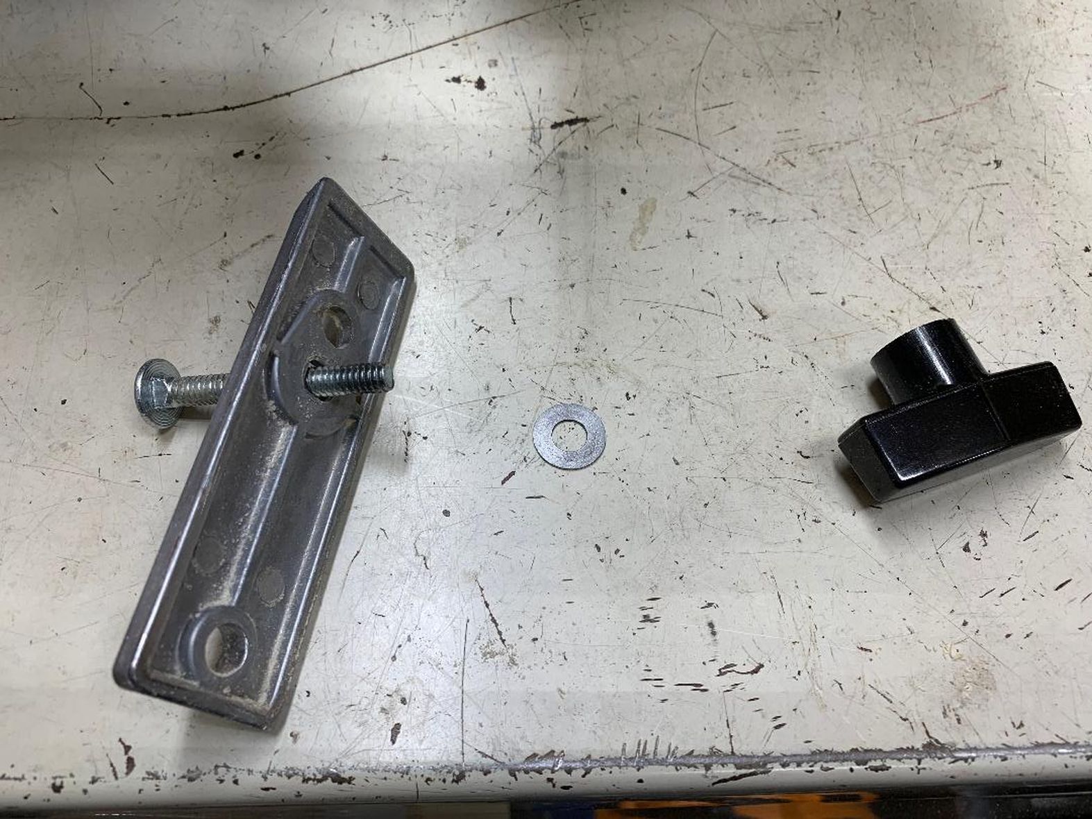

The AL block should also be inspected to make sure there is nothing that would keep it from laying against the knife. You can also check this with out the knife in place in the lower guard.

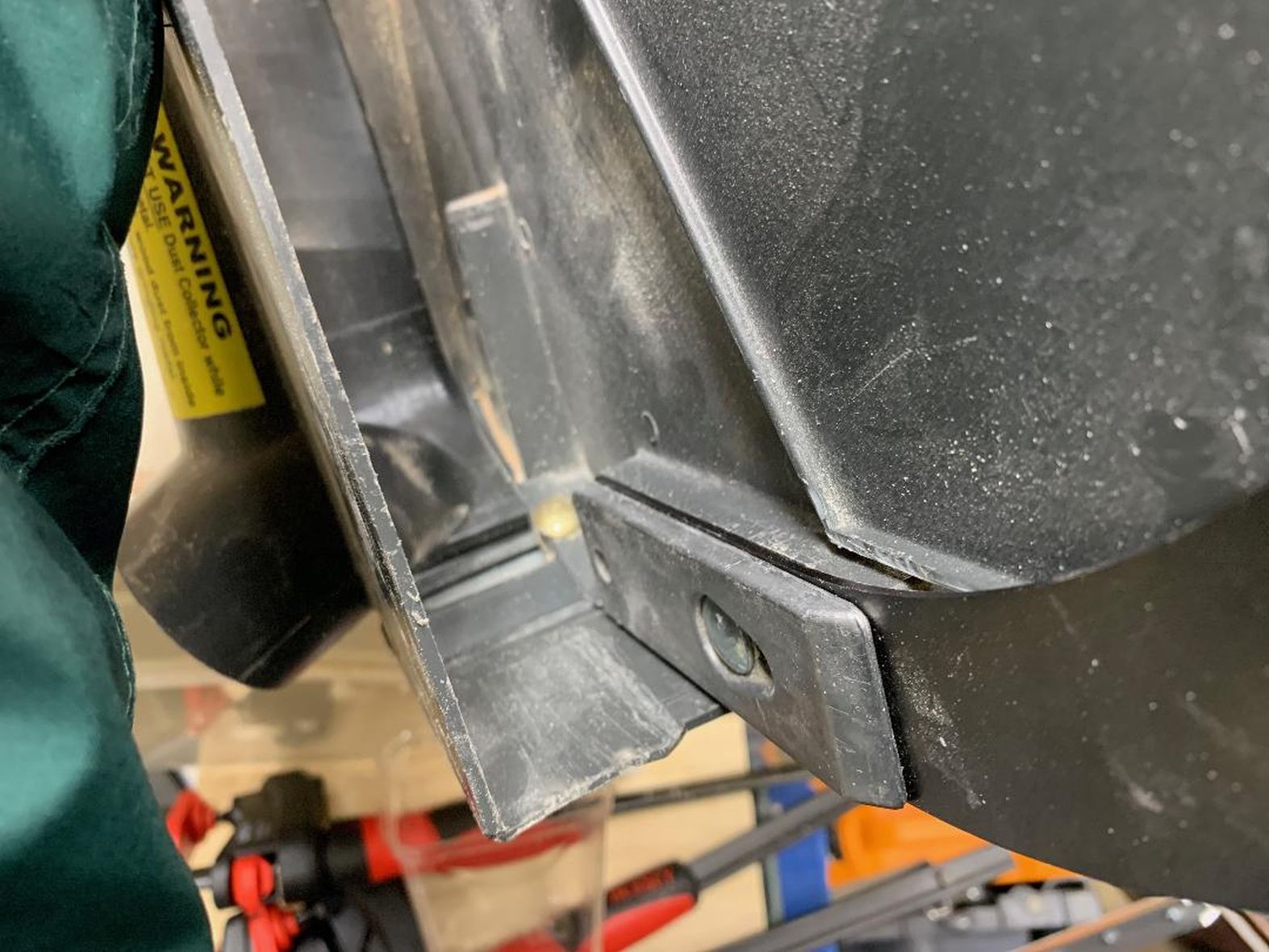

Then put the knife in place and see that it fits flat like shown here:

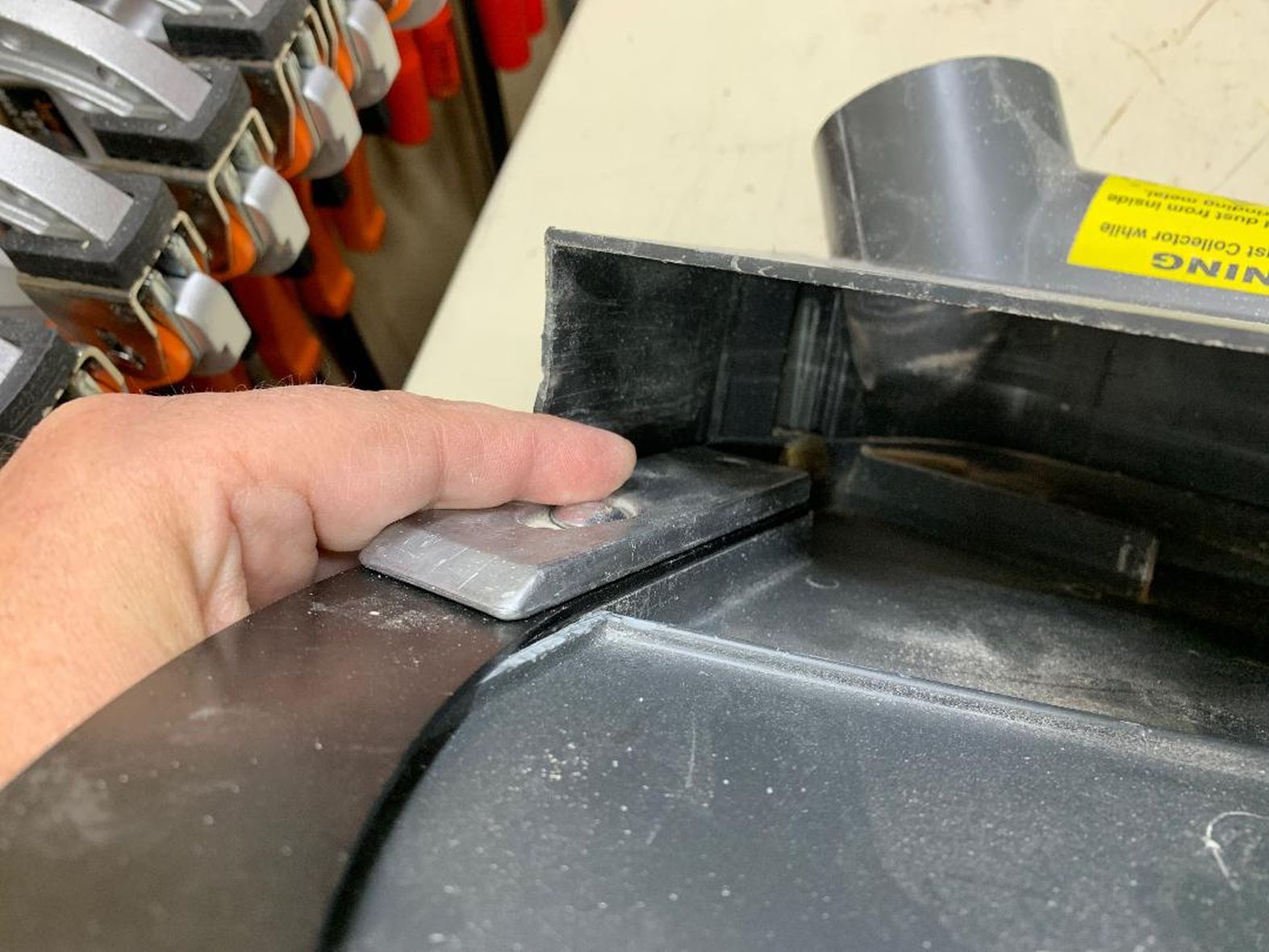

Add the cap without the fastener tightened and see that it sits flat as seen here:
Then put it all together and make sure it is still flat against the parts when tightened. If we got lucky the problem should have surfaced by now and you have fixed it.
