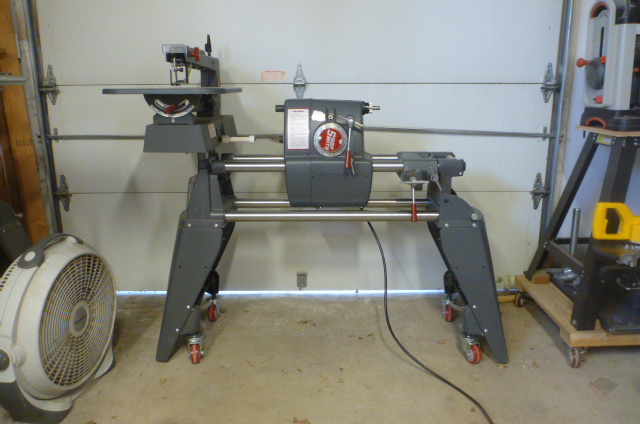

I guess it primarily depends on what you are going to use the shorty for. There are many many different opinions from the members here and none of them are wrong. For me, I wanted to retain the carriage so I could use the main table, so I cut 18" from the tubes.

I opted to go with a 2/3 size machine meaning that I cut 16" off. I did this so the two old shopsmith red cabinets can fit under if I so choice to put them there.

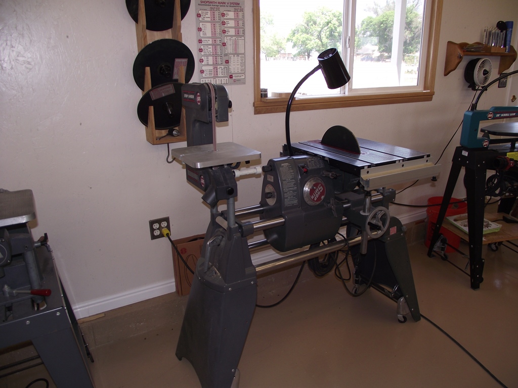

I would start there. You can always make it shorter. I use mine mostly as a sanding station so 18" has worked fine for me. The disk sander with the main table and lower saw guard for dust collection and then either the strip sander or belt sander on the left end.

If you expect to ever use the Shorty as a drill press, you don't want it shorter.
With it at this length, mount the table and check for clearances when to attempt to tilt the table. There is very little. None to spare. I too cut 16" and occasionally wish it had only been 14".
