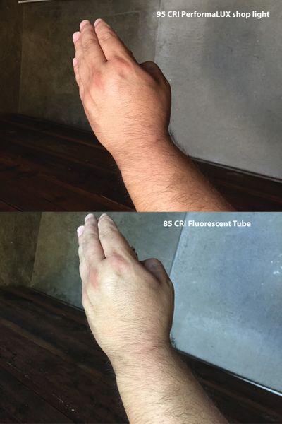

There are a lot more choices in LED lighting now than there were a few years ago. I bought two 4' LED replacement tubes (built-in drivers) and rewired a fluorescent fixture for them in my shop about 5 years ago. Today there are much better choices in complete fixtures for the shop than what I did before. I just redid my entire shop with LED fixtures and it was expensive because I chose to look for fixtures with a CRI (color rendering index) that was greater than 90. Actual fixtures I installed are 95 CRI. Most LED fixtures on the market have a CRI of only 80, meaning their light doesn't render color as accurately. I also chose a color temperature of 5000K. Natural daylight varies between 5000-6500K and is typically 5600K at noon on a clear day. I only found one manufacturer (American Green Lights) that guarantees a high CRI and I wanted to try to get as accurate of a color reproduction as I could in the shop so that I could see the true color of the wood and the finishes that I apply. I am not advising that anyone else follow this approach unless you have had the same concern as me and want a high CRI in your lighting. See pic below for color comparison of 85 to 95 CRI.
American Green Lights were helpful and ran a simulation of my actual shop by entering all of my shop dimensions, workbench locations and Shopsmith placement. They sent me a simulation of what the actual lighting would be in my shop showing hotspots and how their recommended fixture placement would yield a fairly uniform distribution of light with greater than 60 foot candles at all table & tool locations. I just finished installing the fixtures as they recommended and I am happy with the results. Whether it was worth it or not, I won't know until I get to the finishing stage on a project. Below is a helpful quote from a rep at American Green lights with some rules of thumb for shop lighting.
"A wood shop should have a minimum of 60 foot candles which can be achieved uniformly throughout the room with approx. 1 watt per square foot. "
http://www.americangreenlights.com/shop ... ounts.html
http://www.americangreenlights.com/high ... ights.html
P.S. I went with 6 of their SL-4L-48-50 fixtures (4' long, 48W, 5000K) in my main shop and put another 6 in the rest of my garage.
