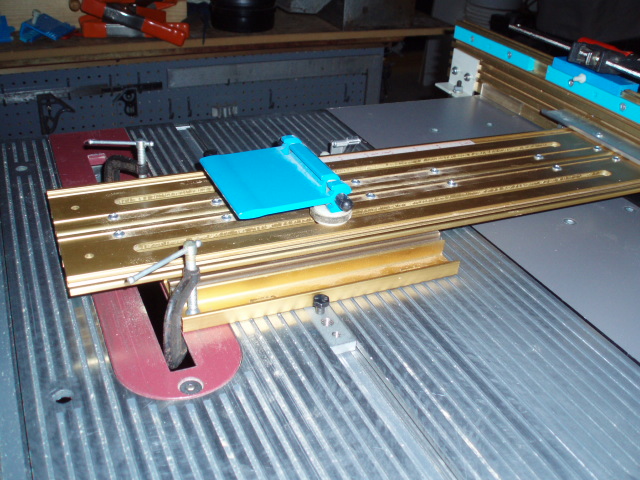

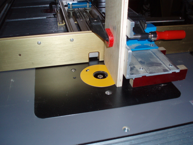

I wonder if I am the only one who frequently wishes he/she had a floating table (or extension table) with a T-Track.
My latest experiment involves the Incra Pro. Original instructions say to mount it on a piece of 3/4" plywood and to then clamp that to the extension table.
Being as contrary as I am, I ask why the plywood? Why not use T-Bolts and the T-Track? Why, because there is no T-Track in the area needed but that could be solved if I had a floating table that was so equipped.
[ATTACH]2017[/ATTACH]
[ATTACH]2018[/ATTACH]
A floating table inserted to the left of the router table may allow the use of the T-Track in the main table. I'll try that tomorrow but I would still like to have a floating table with a track.

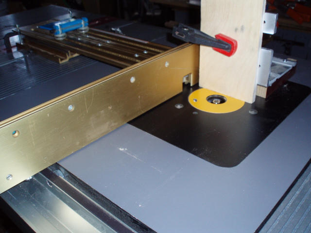

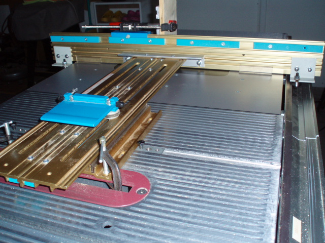

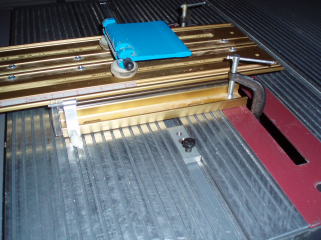

[ATTACH]2019[/ATTACH]
[ATTACH]2020[/ATTACH]
[ATTACH]2021[/ATTACH]

By strategically locating the tables and the Incra Jig Pro - there is no problem. I flew off the deep end for no reason at all. When will I ever learn that these people (people like Shopsmith and Incra) have my best interests in mind. All I have to do is study the options.
In this case, I am able to mount the Incra Pro to the Main Table utilizing the Main Table T-Tracks. One versus the other simply provides for a variation is distance from the cutter.
I had to enlarge some predrilled holes in the Incra Jig Pro Mounting Base to accept the screws used in the t-nuts but that was a no brainer.
Pictures will follow if I get some time in the shop today. The CEO has other plans for my time today.
