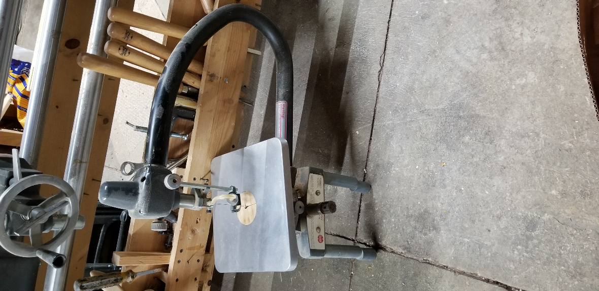

I have the 18 inch saw I have only used it a few times seems my daughter's use it more then me

Thatsa 'jig' saw fer sure. Yes it mounts high off the floor so standing can be an issue.

JPG I have a rubber floor mat that helps , however it only works for a short while .

OK, that is certainly a way to get started. I have two here and my wife used then to produce some nice things for a long time. They work well but a true scroll saw works better and is much smoother. Start with what you have and then go on.

As John said the Scroll Saw is better and provides a smoother cut for what you are wanting to do. A Scroll saw has two arms moving together providing even tension on the blade throughout the up and down cycle of the cut. A Jig Saw has a spring tension in the upper arm to pull the blade back up and also provides tension on the down stroke. Don't get rid of the Jig Saw though. It has it's uses. One thing it can do a Scroll Saw cannot is work as a Sabre Saw with the upper arm removed. A nice feature for cutting shapes in larger panels. I have both saws which I use for different purposes. I found my Scroll Saw, a gray one, used with a Power Station. A combination I like since it is not as bulky as it is sitting on a Mark V. Buying a stand alone Scroll Saw would be similar.
