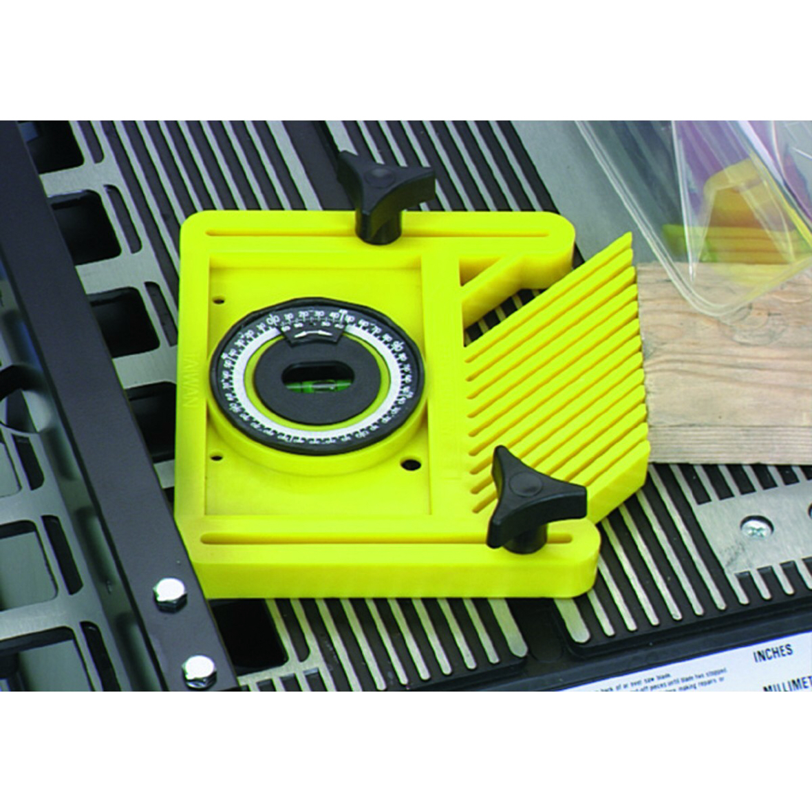

If you just can’t wait for that antique priced OEM ShopSmith Feather Board to arrive. Or only have $6 & a 20% coupon. You might want to drop in to Harbor Freight & pick one up.
1st take the clamps over to the belt sander & melt them down to the standard 3/8” slot size.
This should, if you were as fortunate a child as I was, bring back fond memories of making your own custom panels on your Vac-U-Form. To use with your city of Girder-N-Panel sets with Monorail service to the Airport.
Then if you want to feed from the Right of your blade snap that confusing mess out of the middle.
Unless you use your table saw in the vertical position. Then it may be some use if you want to feed from the Left. But it IS NOT swappable to the other side.
Next remove the O-rings from the screws & toss them. Assemble the thing & fit into a slot.
Now you have 4 usable inches on a 10er. When it stops raining long enough to pull it out & cut something I will update.

Gotta love the setup in this pic from Harbor Freight. Can’t get any safer or more accurate than that! :rolleyes:
I do remember the melting-plastic smell from my own childhood Vac-U-Form. Do you still have yours, or just your vacuum-formed nameplate, or just the pic of it?
And why can’t you flip the featherboard over and use it in the left-hand miter slot?

Like the picture shows, it's only made to work from the left. If you flip it over to work from the right it's wobbling on that ring around the numbers.And you would have to grind it down till the numbers were gone to get it to sit flat. I tried to take it apart thinking you could re-assemble it on the other side. But you can't, it's made to only go together one way. I couldn't find it at HF so I asked the woman that has worked there for years to help. She told me she had never seen it & doesn't remember ever selling one. And the fact that Lowes only has one & Home Depot none shows that I'm not the only one who has never thought about having one.
